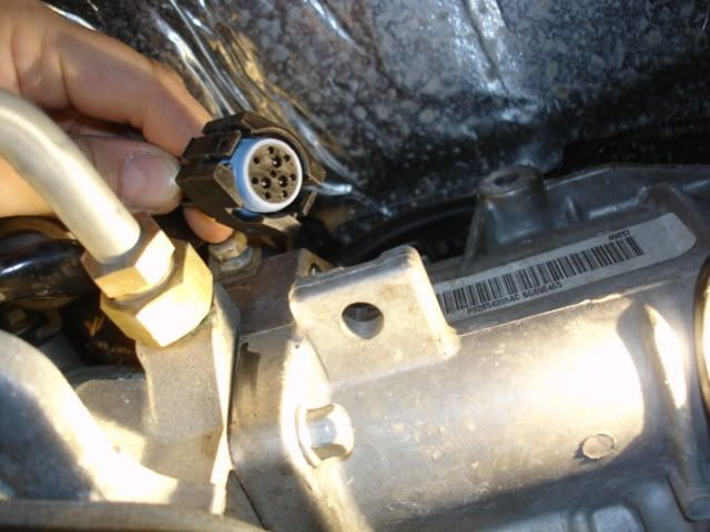

Of couse I didnt invet the mod, but it was very easy.
Heres my switch:
Basically tapped into the harness , find the correct wire and put a switch in to ground it.
The only other thing was to put in a resistor in line to keep the signal from reaching the computer and throwing the MIL.
If someone has the wiring diagram for the Jeep trans lock up, we could compare it to the Dodge's.
chuck
