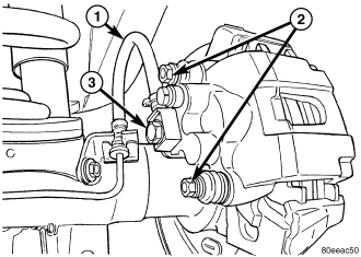

1. Raise and support vehicle.
2. Remove rear wheel and tire assembly.
3. Drain small amount of fluid from master cylinder brake reservoir with a clean suction gun.
4. Bottom caliper pistons into the caliper by prying the caliper over.
5. Remove brake hose banjo bolt (3) and discard gasket washers.
6. Remove the caliper slide pins (2).
7. Remove caliper from the adapter.
8. Remove the brake pads.

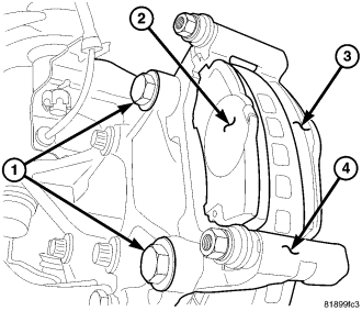

Those are instructions on how to competely remove the caliper like if you were going to replace it also.
I would guess to do the pads it's nothing more than remove the 2 bolts, pull the caliper, change pads, and stick it back together.
If you pull the banjo bolt you'll have to bleed the brake system.
From the manual. . .
2. Remove the wheel and tire assemblies.
3. Compress the caliper.
4. Remove the caliper (I.E. pull the 2 slide pins.)
NOTE: Do not allow brake hose to support caliper assembly.
5. Support and hang the caliper.
6. Remove the inboard brake pad (3) from the caliper adapter (1).
7. Remove the outboard brake pad (4) from the caliper adapter (1).

You are right, sorry was on the wrong page right area.
Added photos for Hip2u77's post
