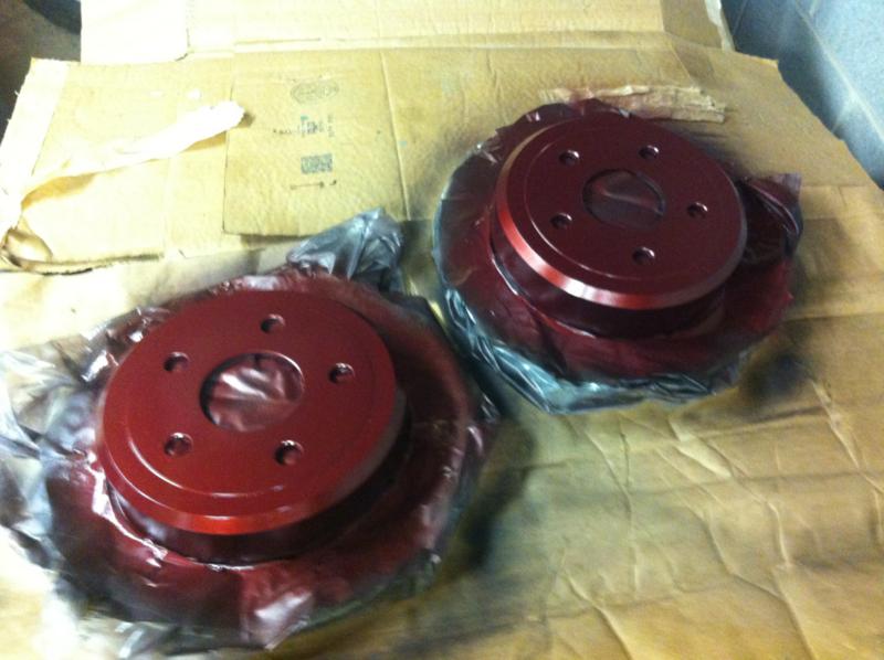

I just did the rears this morning. Piece of cake. This set was only a few bucks more than cheapo stuff from Advanced Auto. Also came with ceramic pads.
Oh I painted the rotor hubs too.
