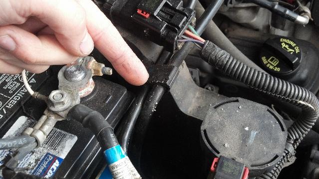

The misfire problem could be from the cracked manifold, although if it was because of the exhaust manifold you'd likely be getting backfire through the exhaust not the air box. There are two plastic lines that run right next to the air box that will rub and develop a leak when the tube gets a pin hole on the underside and its hard to notice even when you're looking for it. Double check the two plastic lines right near your air box/battery, its dark outside here now so I'll shoot ya a pic in the am if you can't find it

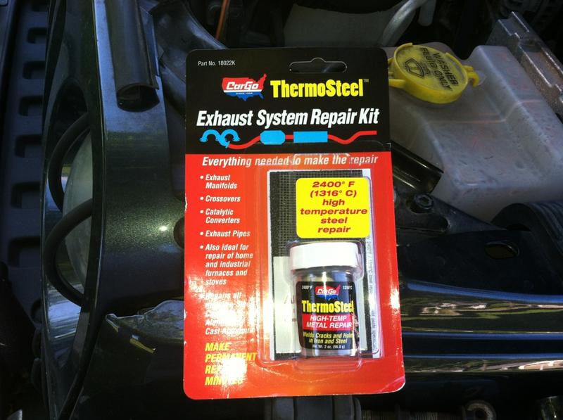

what i did was run a bottle of seafoam through the brake booster vacuum line and you will see every spot where there is a leak. Mine was leaking bad at the manifold and when i removed the heat shield there were two large cracks. Simple fix...used a product called thermosteel on the cracks and 8 months later it is still holding strong...nice and quiet now with no hesitation or rough idle.

The p2172 code is for a vacuum leak and this can cause your misfire code you are getting too. Definitely look over all your vacuum lines while your doing the headers, I'm trying to attach the pics of the plastic lines that can leak and my phone isn't attaching them. I'll send them from the computer in a little bit. One comes off the intake manifold right near the throttle body (i can't remember where the other one comes from) both meet right in front of your battery and are pre bent hard plastic. Look them over real good for thin spots especially on the bottom where you can't visually check
