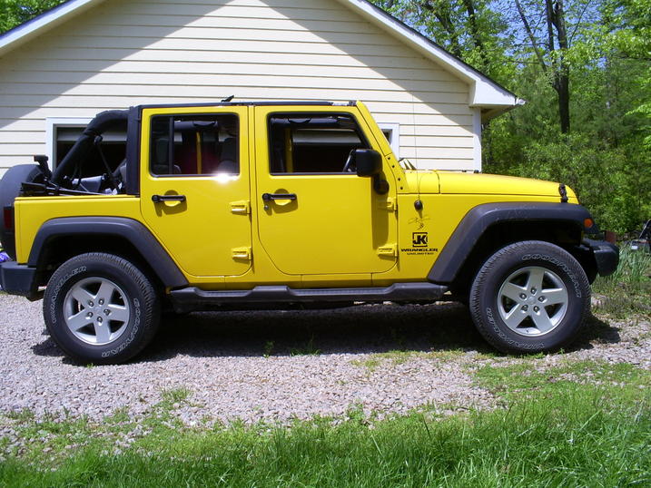

Hi Jeremy- yeah I guess all JK's have a forward rake. When you add a winch and steel bumper it can really drop down there. Mine has the heavy duty suspension and still had an 1 1/2'' rake with no mods. I measured from the center of each flare opening to the ground and it was an 1 1/2'' difference front to rear. I ordered 1 3/4'' front spring spacers from RE and installed them leaving the factory 1/4'' spring pad out which gave me the 1 1/2'' raise I wanted. $50.00 and 45 minutes. No shock mods and no alignment needed.
