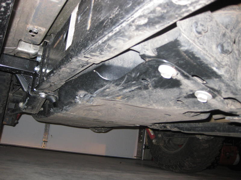

Pic says it all - should I remove it and hammer out the dents? Also - it kinda looks like before I wheel this around here much more I should invest in the RockHard skid. I've read that the stock skid plate holds the tank up? Is that true? Will un-bolting the stock skid drop the tank?!
I'm VERY dissappointed in this stock fuel tank skid - it should be atleast as thick as the stock transfer case skid - the fuel skid is damn thin. Sure glad it's there though!

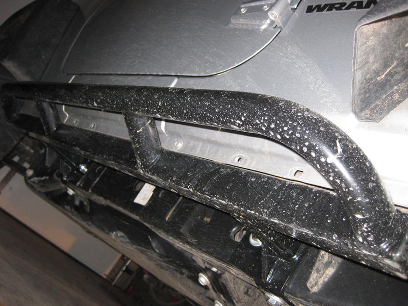

Also a pic that shows the Shrockworks slider from passenger side I just installed last night. Only took 2 months to get them so not too bad. Also better side angle view on how much that fuel tank skid is dented - and for good measure a shot of the terrain we wheel this stock Rubicon in (i.e. the "how" of these dents lol).

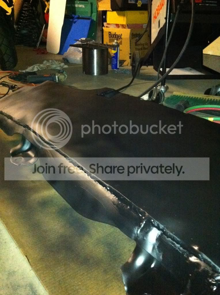

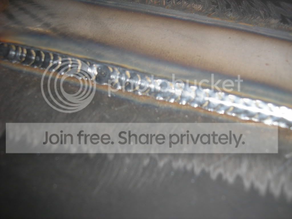

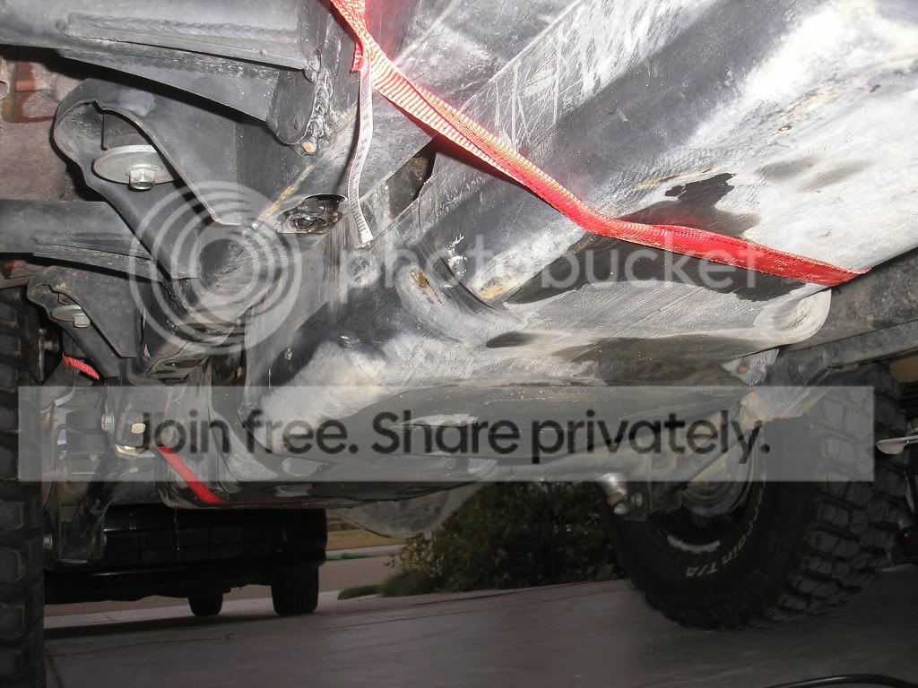

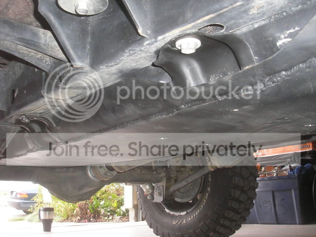

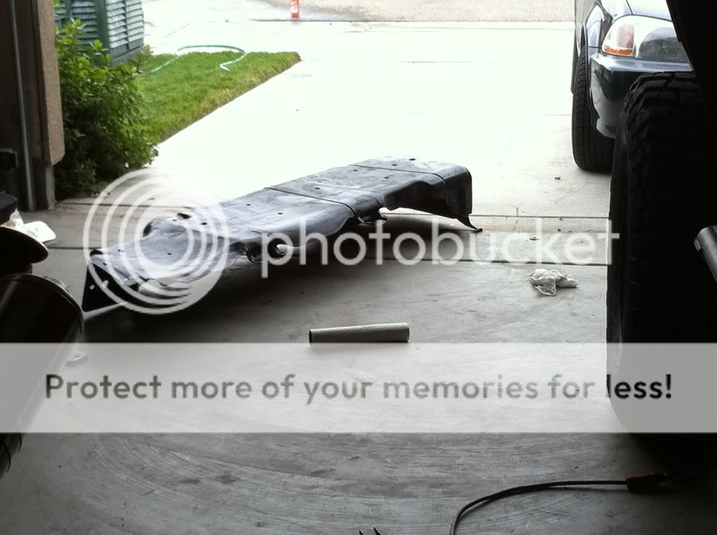

Here was my solution.
The dents:

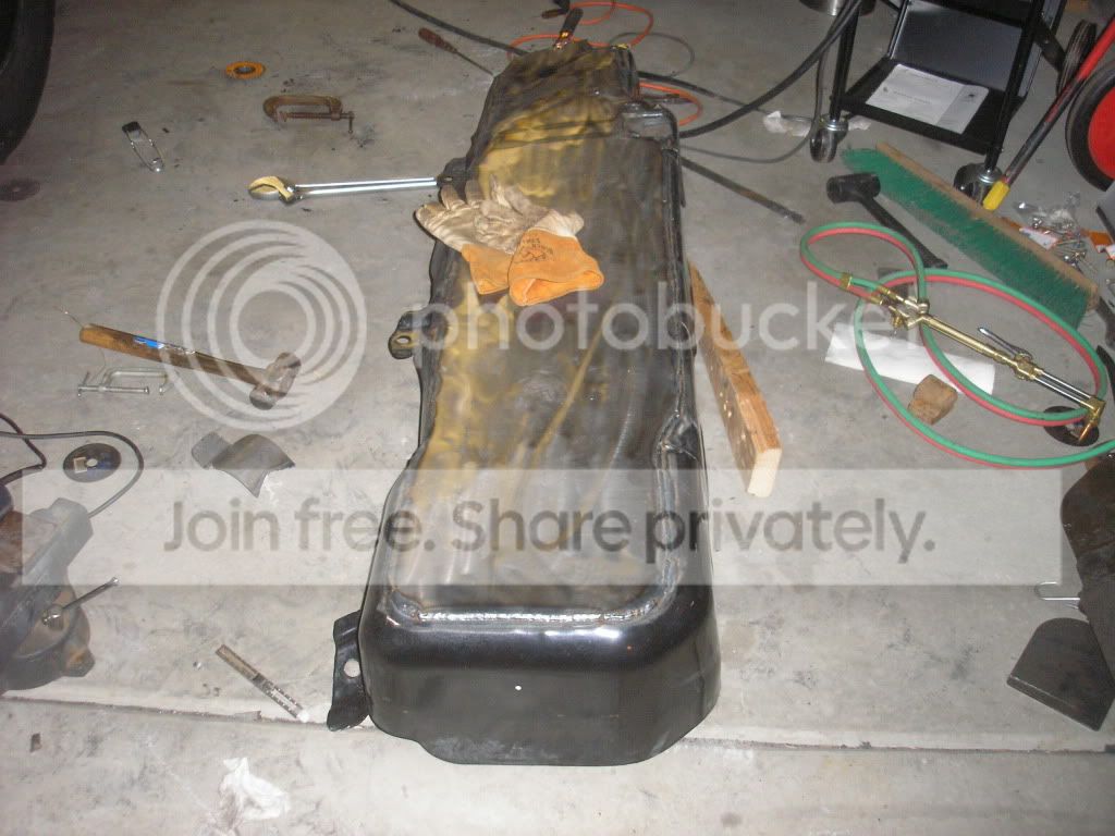

Removal of the skid. Strapping the fuel tank:
Before I beat out the dents:

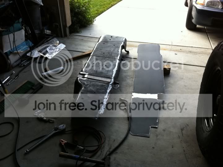

The 3/16" plate overlay:

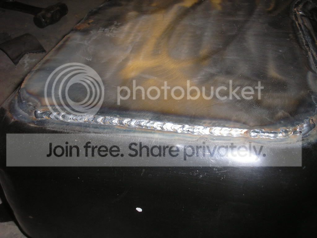

My best weld on the whole project:

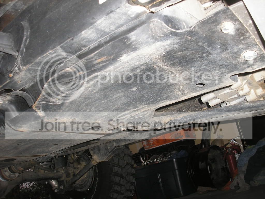

Painted:
Reinstalled:
I would say it's 3x stronger than the factory. Minimal weight gain and I did it myself.
