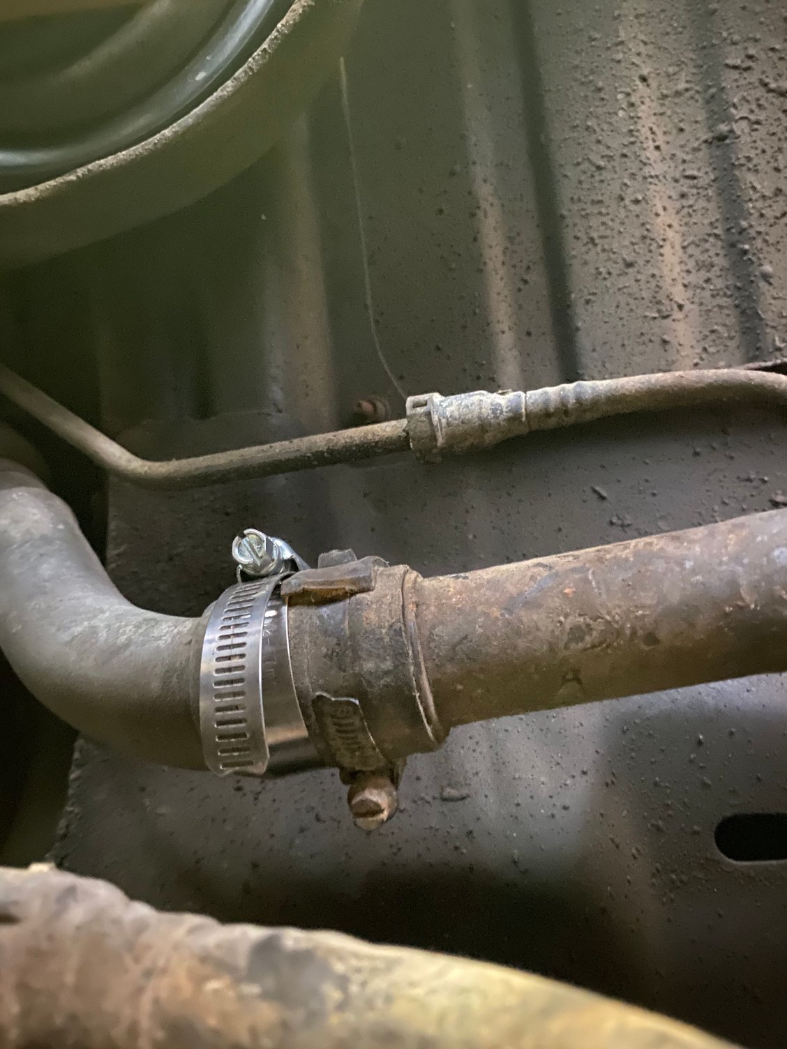

Old May 5, 2021 | 01:18 PM
  #26
John Reams's Avatar
Joined: May 2021
Posts: 6
From: Louisville, KY
Originally Posted by Yemx
Yeah, those hard lines are a bear... If your fix didn't work, just get a replacement line, they're not that badly priced.
Here is old next to new. You can see some kind of plate on the old one and when I tried to lift up on it, it wouldn’t budge and seemed to be taking rubber with it.
Old May 6, 2021 | 07:51 AM
  #27
John Reams's Avatar
Joined: May 2021
Posts: 6
Well the code came back this morning when I used the remote start. So the clamp probably wasn’t the issue. I have noticed the majority of the time the code throws when I use the remote start and it immediately shuts off because of the check engine light. Cleared the code and drove 30 miles to work and didn’t come back. I guess it’s on the mechanic for a smoke test whenever I have the time
