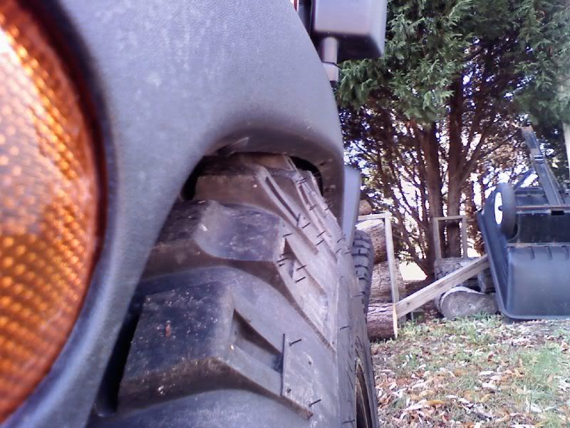

Yes, you can get away with it.
Why trim the flares though? Though some people wheel, not every tucks the hell out of the tires every time. Below is a 31" tire without trimmed flares, but the bind isn't typical of everyday situations.
