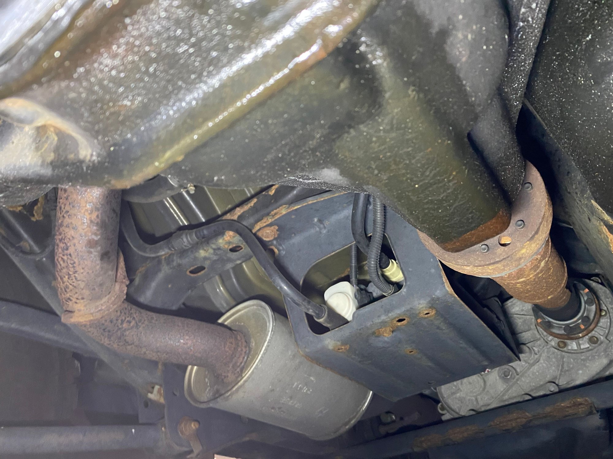

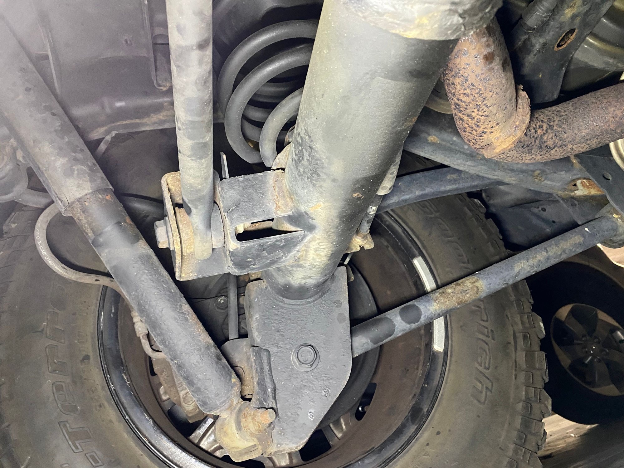

Looking for some guidance. Fairly new to the Jeep world. Just got my first Jeep (2012 JK 2 dr) 6 months ago w/ 93K miles. I've noticed a leak on my rear diff about 2 months ago which I then resealed with RTV and replaced the diff oil. It has been a month or so but yesterday I just noticed fluid coming from the diff area again and oil drops on the floor. The bottom of the diff is wet and towards to middle of the undercarriage. It was my first time using RTV or changing the Diff oil so I'm not sure I did some thing wrong. I smelled the fluid and wasn't sure if it was diff (which is strange cause diff oil stinks bad) Also, I noticed the body of the jeep seems to have a wet substance to it . Do you think I resealed it wrong or that the leak is coming from somewhere else? What are your thoughts on the cause of the leak? I've attached photos too.

It looks to me as though your pinion seal is leaking. It's coming from up there by your driveshaft and then making it's way down to the diff cover before dropping to the floor. That looks like a pretty good leak if you're getting drips to the floor.
What you might do is clean it really good with a degreaser, dry it up, and then monitor after a drive or two. The leak will start to show itself quickly again, and you'll easily see if it's coming from up there at the pinion seal.

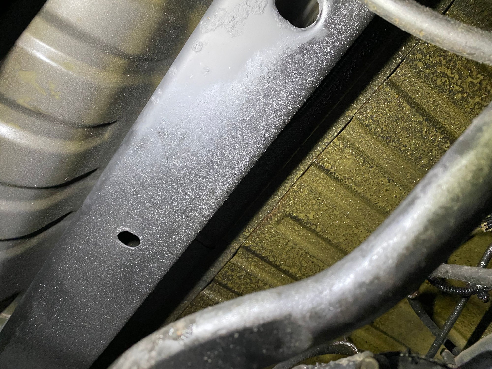

Hey, Thanks for the help! It looks like a pretty straight forward job to replace the seal. How about the oil / greasy film on the undercarriage of the body (shown in the 6th an 7th pic). Can that be diff oil also? or maybe it's some sort of rust prevention fluid (that's just a guess)?

It's really hard to tell on that 6th and 7th pic, but given you are in the northeast, that looks more like an undercoating of some sort....maybe old Fluid Film? That definitely doesn't look like something slug up from the jeep, but I don't live in your climate so I'm less familiar with what people do up there and what it looks like. The only thing is when I consider that to be some sort of coating, why is it not everywhere else? Maybe the jeep was degreased prior to sale?
