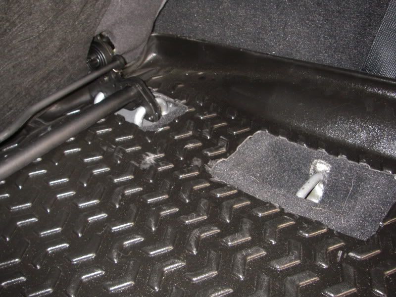

I can run and take a pic of mine real quick to show how the front is locked in.

Here you go:

like they say a picture is worth a 1000 words..I just couldn't help ya w/ that...
