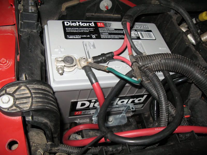

I just replaced OEM battery with the Sears Platinum last Friday. Has 880 CCA while OEM was 600. Also it is a jell battery and you have no place to add water like the OEM. Bought it at Sears for $180 and free installation.

Actually it is an Absorbent glass mat (AGM) battery.
