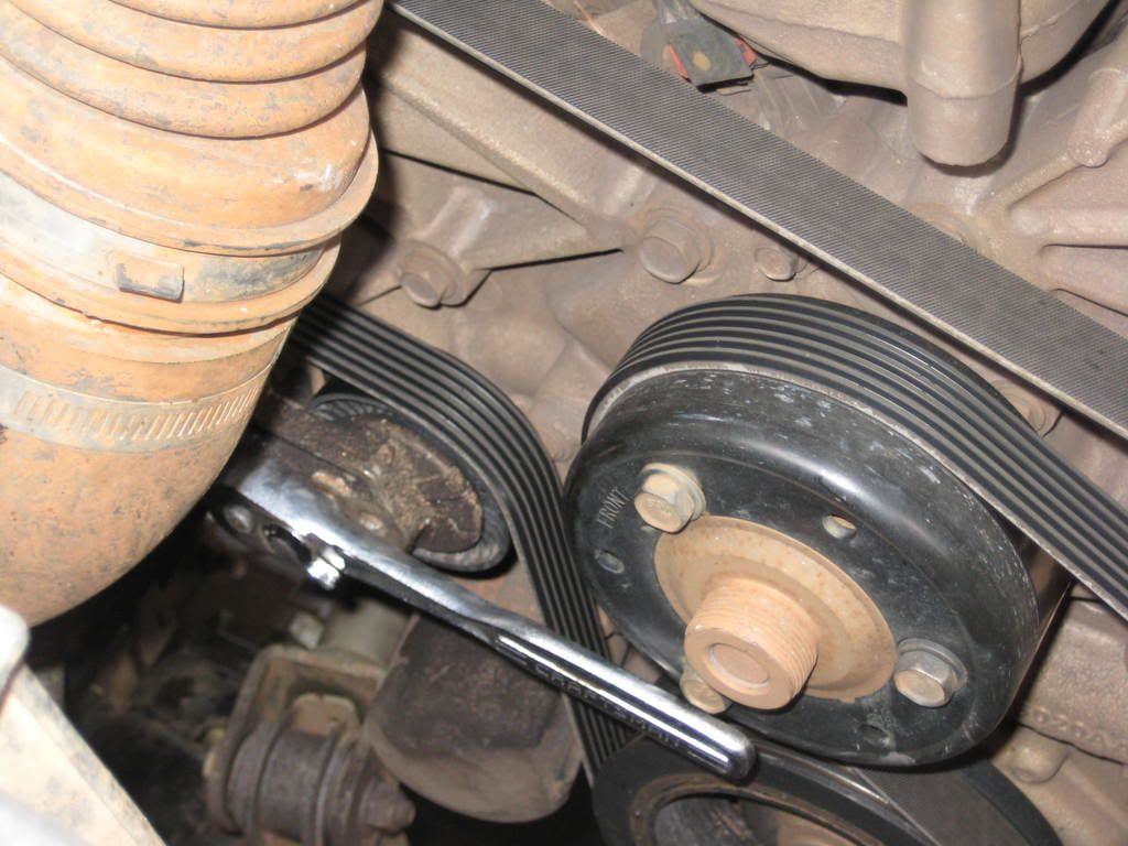

this is the tensioner pulley, with a 3/8 ratchet you can take just enough tension off the belt/idler pulley without even having to fully remove the belt. leave that ratchet there and with another take the idler pulley off, have the new one standing by where you can reach it, takes 2-3min max :thumbsup: beats going to the dealer and being without your jeep
http://i259.photobucket.com/albums/h...0/IMG_1272.jpg
see ratchet in hole to the left

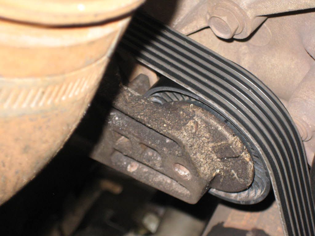

http://i259.photobucket.com/albums/h...0/IMG_1274.jpg
the small black pulley top centerish is the idler pulley, one bolt and thats it
