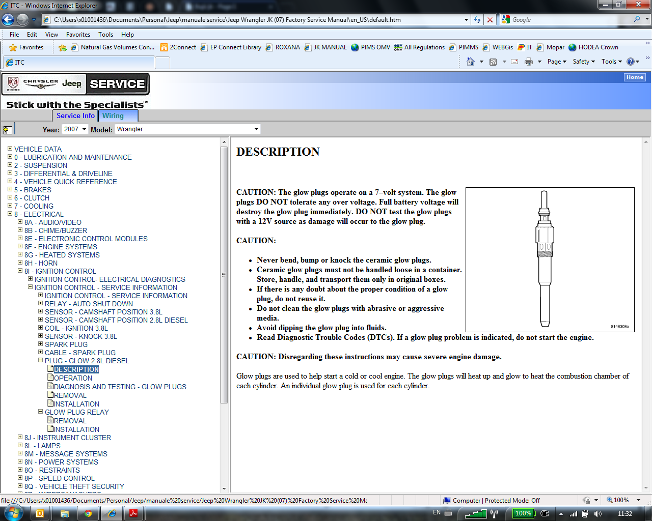

An excerpt from the FSM JK 2007 for the 2.8 CRD engine (177 HP) for those of you which need more info on this topic and how to troubleshoot:
"INSPECTION - STARTING SYSTEM
The following starting system components should be carefully inspected whenever any starting system problem is encountered.

"CAUTION: The glow plugs operate on a 7 volt system. The glow plugs DO NOT tolerate any over voltage. Full battery voltage will destroy the glow plug immediately. DO NOT test the glow plugs with a 12V source as damage will occur to the glow plug.
CAUTION:
Never bend, bump or knock the ceramic glow plugs.
Ceramic glow plugs must not be handled loose in a container. Store, handle, and transport them only in original boxes.
If there is any doubt about the proper condition of a glow plug, do not reuse it.
Do not clean the glow plugs with abrasive or aggressive media.
Avoid dipping the glow plug into fluids.
Read Diagnostic Trouble Codes (DTCs). If a glow plug problem is indicated, do not start the engine.
CAUTION:
Disregarding these instructions may cause severe engine damage.
Glow plugs are used to help start a cold or cool engine. The glow plugs will heat up and glow to heat the combustion chamber of each cylinder. An individual glow plug is used for each cylinder.

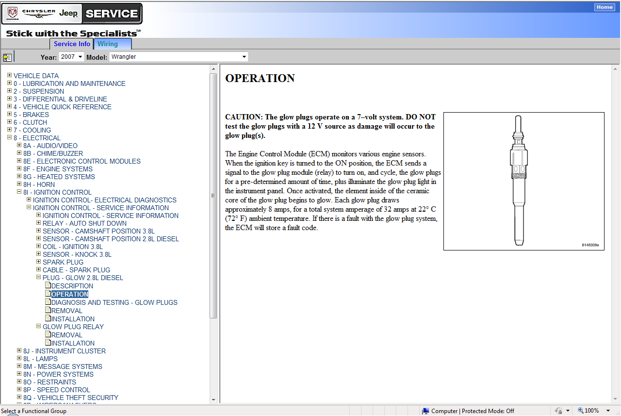

OPERATION
The Engine Control Module (ECM) monitors various engine sensors. When the ignition key is turned to the ON position, the ECM sends a signal to the glow plug module (relay) to turn on, and cycle, the glow plugs for a pre-determined amount of time, plus illuminate the glow plug light in the instrument panel. Once activated, the element inside of the ceramic core of the glow plug begins to glow. Each glow plug draws approximately 8 amps, for a total system amperage of 32 amps at 22? C (72? F) ambient temperature. If there is a fault with the glow plug system, the ECM will store a fault code

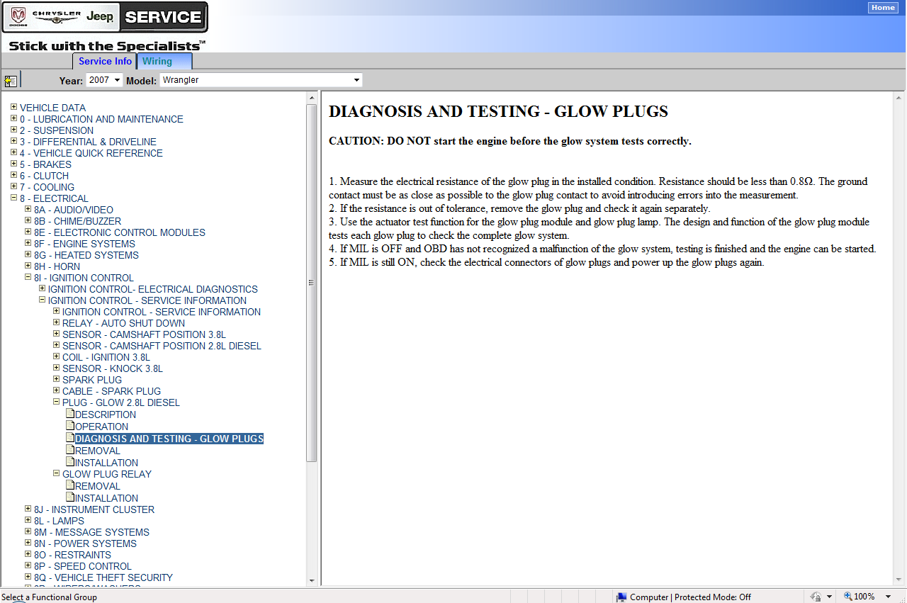

DIAGNOSIS AND TESTING - GLOW PLUGS
CAUTION: DO NOT start the engine before the glow system tests correctly.
1. Measure the electrical resistance of the glow plug in the installed condition. Resistance should be less than 0.8Ω. The ground contact must be as close as possible to the glow plug contact to avoid introducing errors into the measurement.
2. If the resistance is out of tolerance, remove the glow plug and check it again separately.
3. Use the actuator test function for the glow plug module and glow plug lamp. The design and function of the glow plug module tests each glow plug to check the complete glow system.
4. If MIL is OFF and OBD has not recognized a malfunction of the glow system, testing is finished and the engine can be started.
5. If MIL is still ON, check the electrical connectors of glow plugs and power up the glow plugs again. "

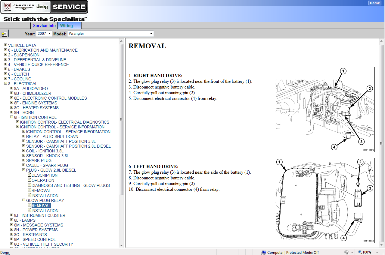

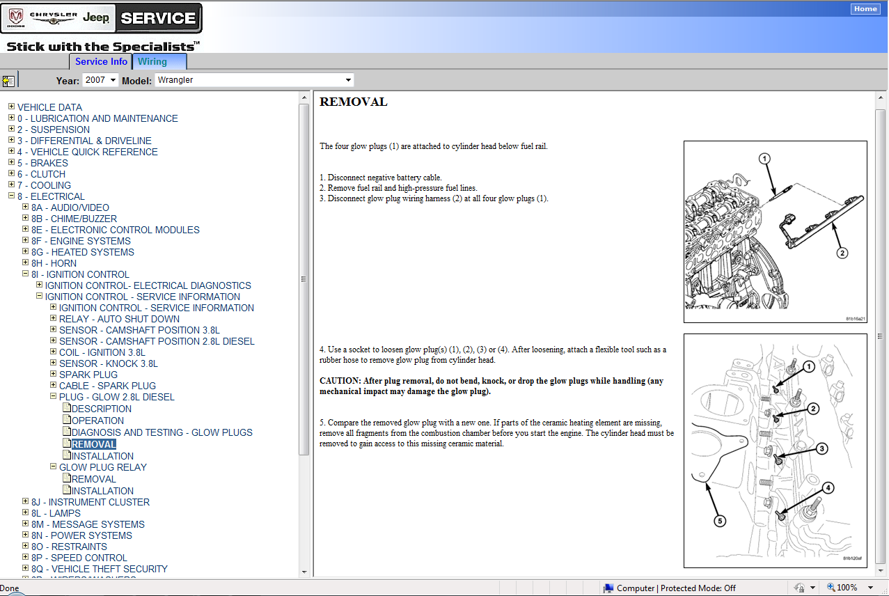

Some excerpts from FSM (print screens)
And some part no/codes:
1. GLOW PLUG - 68029497AA (USA ~ 48,40 USD) (in Europe search also for ADA101805)
2. GLOW PLUGS WIRING - 68027381AC or 68027381AA or 68027381AB (USA ~ 89 USD)
3. GLOW PLUG MODULE - 05033351AA (USA ~ 154-199 USD)
Have a great wheeling 2014 out there ...
