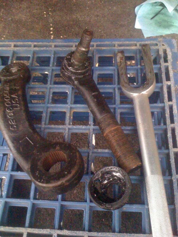

yes it is curved

thanks warlord!! any idea how i could get a measured degree on the curve, i think mine may be curved a bit more than yours in the pic so that might indicate that mine is actually bent. i apologize for harping on this but an oem pitman arm is a little pricey and i would like to put the money towards something else if i can if i dont need it
