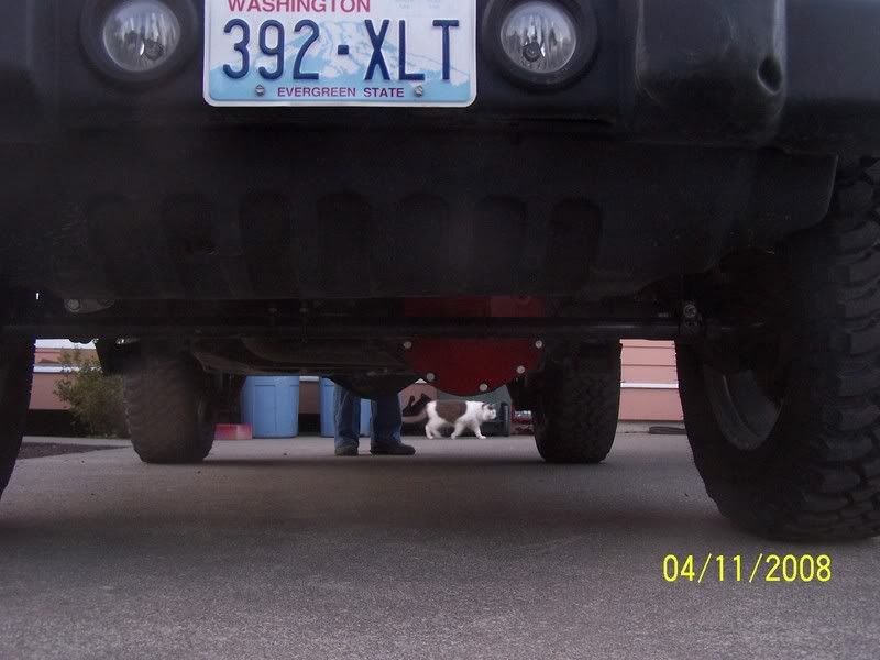

RubyJeep, the 08, had an actuall dripp comming from both front and rear, found out that Rhonda, The owner/driver, drives off-road via braile so she was dragging both diffs. I got her new Riddler diff covers and painted them red and had them installed while our Jeep Tech Guy was looking at them for a "warranty diff leak" so got the fluid replaced while in warranty and now the front has about 2.5 quarts in it and slightly blowing it out the breather.
Got the Riddler diff covers here www.northridge.com , There NOT listed on the site but dave DOES have them in stock.
