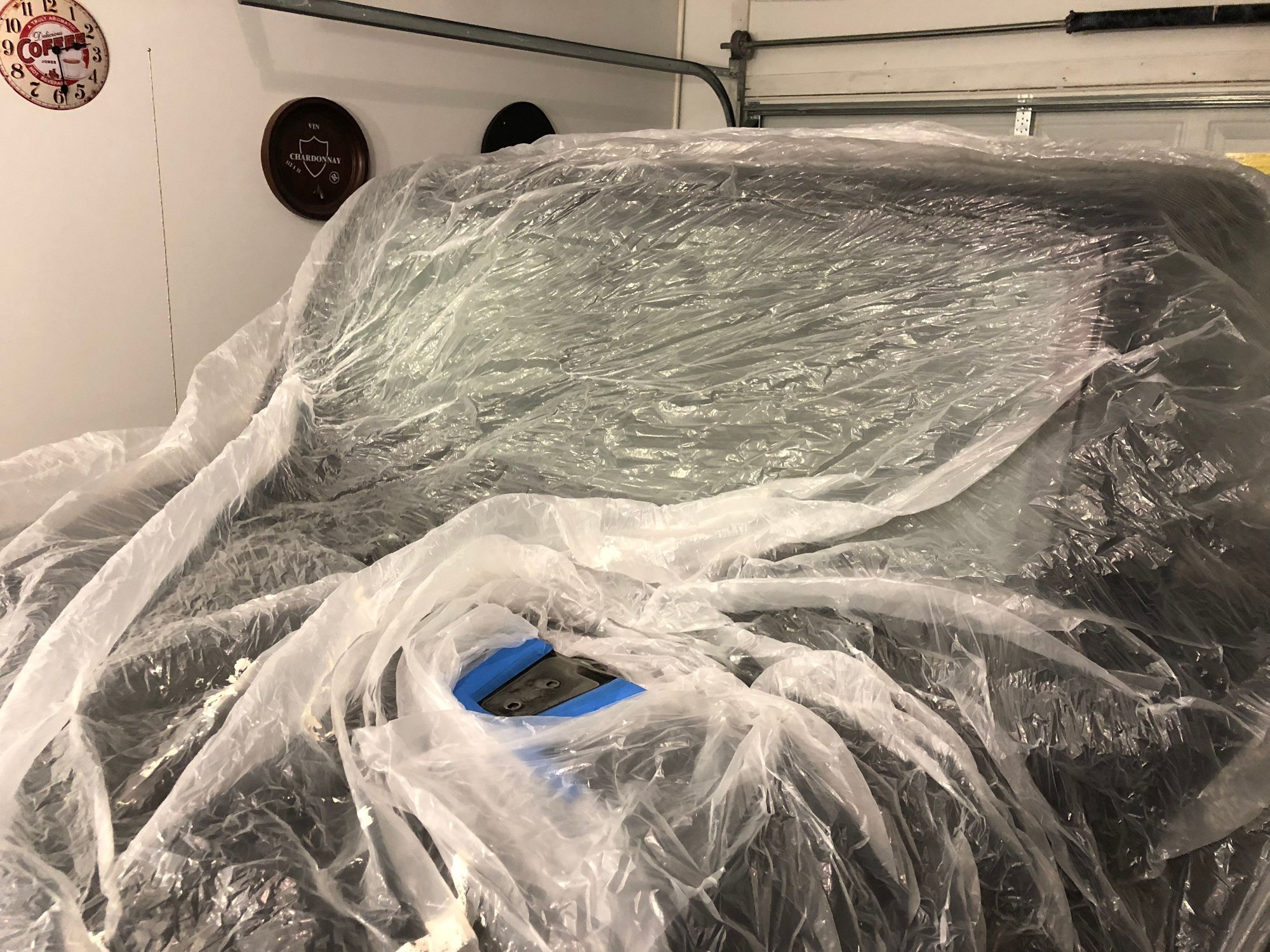

I removed them. Sanded and sprayed with rust stop paint. I then siliconed them down. I think it was a success. The paint job on my first one came out a little from the hinge . You need to get close up to see the imperfections but overall I believe the rust will stop. Now I need to figure out the door hinges and my next steps.
