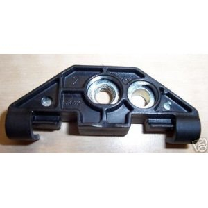

All the tops fits each year model, the only difference is the 2011-12 models was slightly modified with a bigger rear window and the freedom panels mount and secure differently. Old models they clamp to each other in the middle, newer ones they clamp to the middle windshield loop.
As far as putting one on for the first time, all you need is the retaining clips that are seated in the bed lip, the six bolts for the retainers and the two that screw through the sound bar into the freedom panels, and some help lifting the top.
