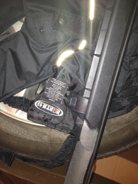

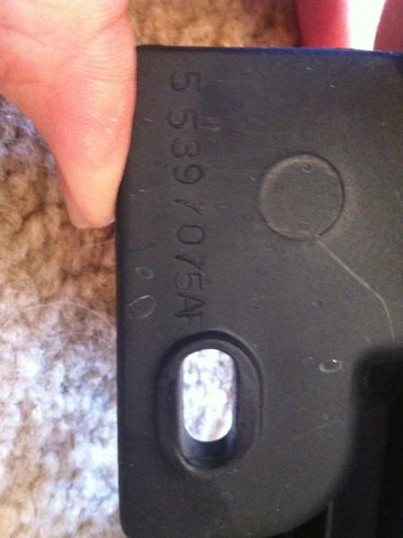

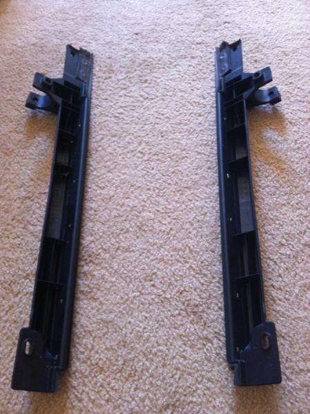

Pics of mine 2010+ Unlimited Soft Top with newer style cabling system
Drivers side on right, passenger on left
1st picture, top side down, the top of the picture is the most front portion (windshield side), bottom of picture is where it sits in the trim for the rear door surrond
2nd picture is a look down the passenger side, top side down from the back of the surround to the front.
3rd picture, is a showing top side up, passenger side on right, drivers side on left.
4th picture, passenger side part#
Passenger side part# 55397074AF
Drivers side part# 5539707AF
hope this can help

Think you for your help, from your pictures it seems my pieces were mixed and matched from the dealer. My friends vehicle was a demo unit when he bought it, came with dual tops, but the additional boxes that typically come with it were missing so the salesman re ordered everything new, that must have been where the screw up was. typical sales man lol
