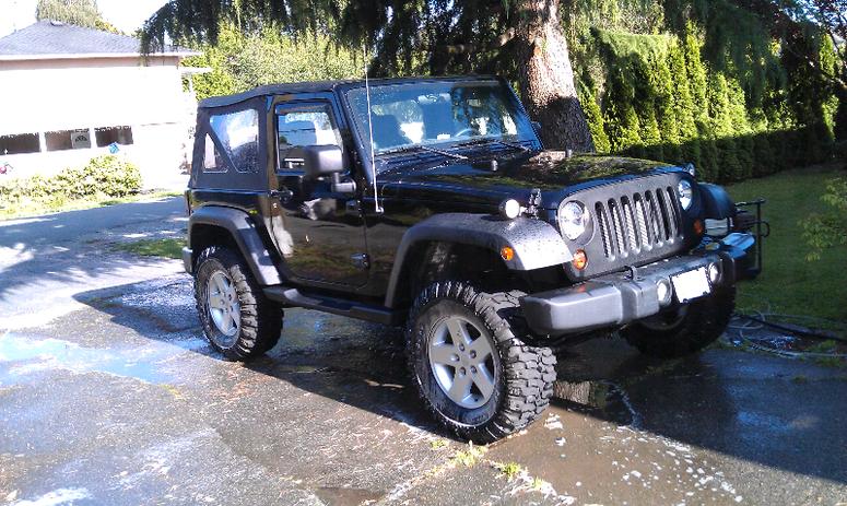

Swapped mine out to 19's up front, 60's rear and ruby shocks with 3/4" spacers up front... 2.5" taller than stock sport suspension..... Very much like it.....

Those 295's look perfect on there!I can't make up my mind 285's or 295's do you have any other pictures ? nice jeep.
I have 1.5" wheel spacers, they rubbed the swaybar before..... Heres pics
