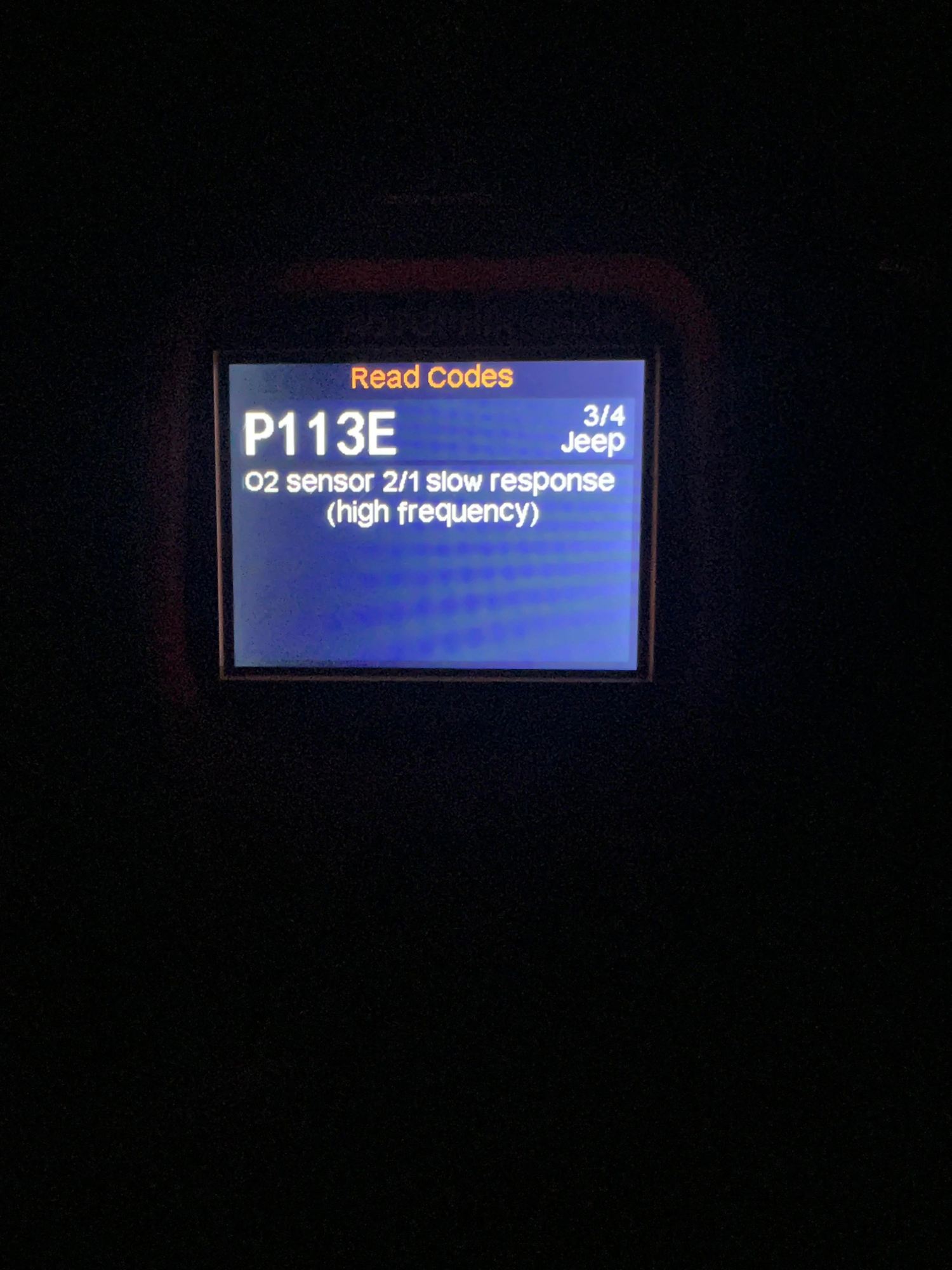

2012 Jeep JKU, I have been dealing with a re-occurring code for my driver side upstream O2 sensor.
The code is: P113E, O2 sensor 2/1 slow response (High Frequency)
I have:
- Purchased a new NTK O2 sensor
- swapped both upstream sensors
- Checked for any cuts or open wires on the connector

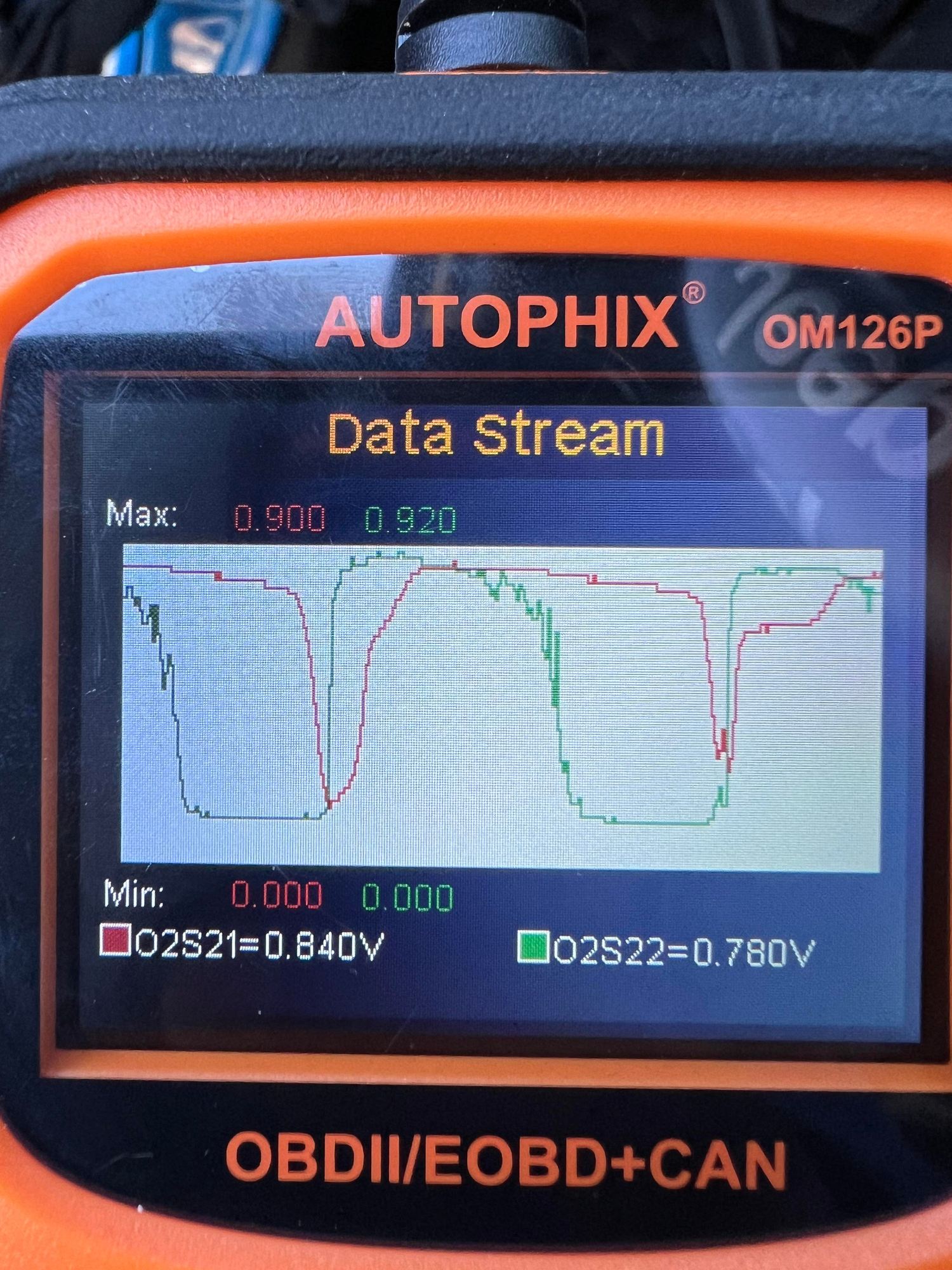

- Used my multimeter to check for voltage, voltage is the same for all connectors including the one in question
I am stuck trying to diagnose. Any help would be greatly appreciated!
I have attached some pictures of my scanner graphs for comparison of banks.
