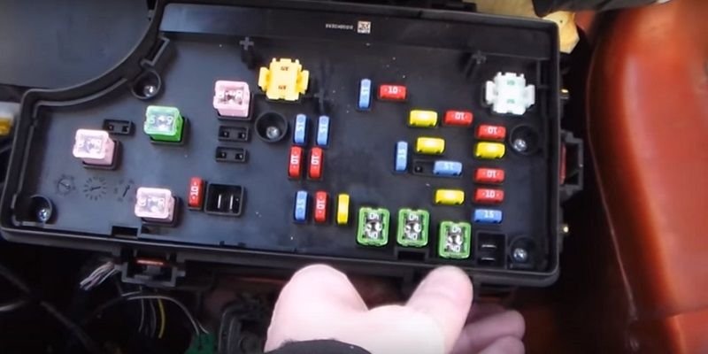

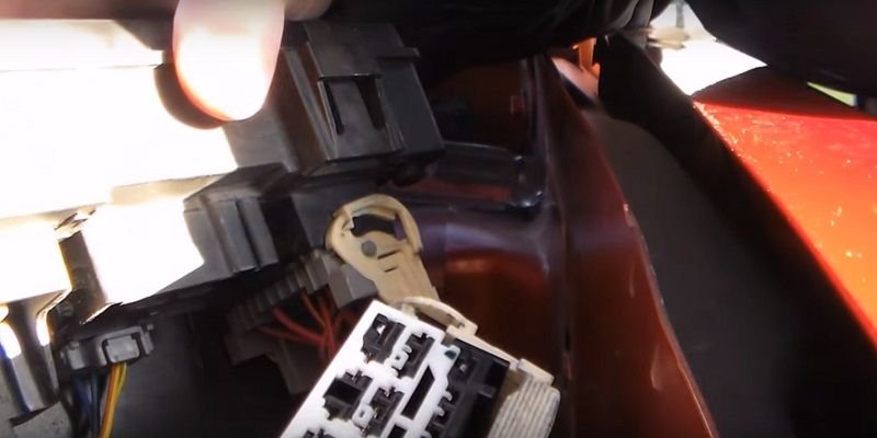

Lift the hood and disconnect the negative (black) battery cable before beginning. Remove the cap of the TIPM with a 13mm socket and ratchet. Remove the lead going into the TIPM with a 10mm wrench. Remove the clips that secure the TIPM to the Jeep using a small flat head screwdriver. Carefully unplug all of the connections on the bottom of the TIPM by pushing in on the small black release in the center of each grey clip with a screwdriver, then rotating the clip downward to release it. Once all of the connections are removed, pull out the TIPM.
  • Figure 1. Remove the cap and release the clips holding the TIPM in place.
  • Figure 2. Remove the connections from the bottom of the TIPM and remove it from the vehicle.

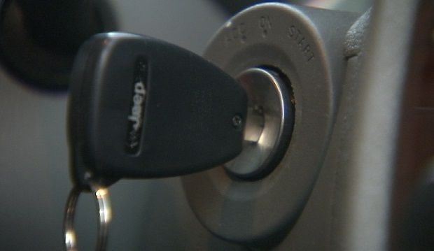

Insert your key into the ignition and turn the key to the "on" position for 12 seconds. This allows the new TIPM to collect all of the necessary vehicle configuration and VIN data from the PCM and CCN. Turn the ignition off, then start the vehicle as normal to verify that everything is working correctly.
Figure 5. Turn the key to the "on" position for 12 seconds, then turn it off and start the vehicle.
