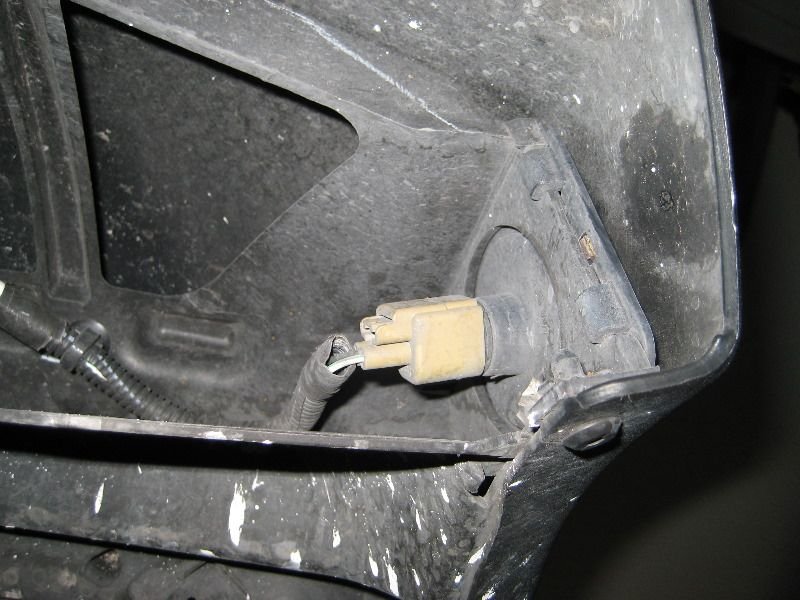

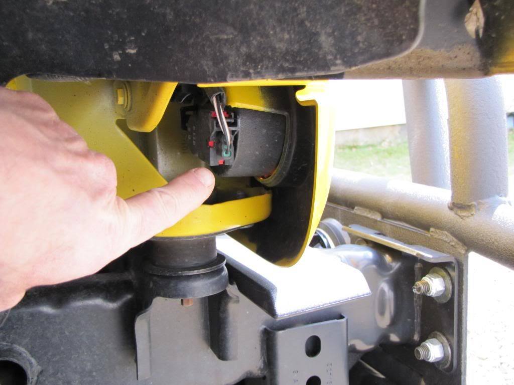

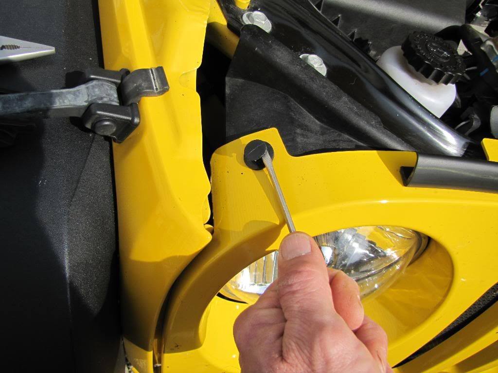

Remove the grille. It's held in place by six clips, stick your flat head screwdriver under it and pry it up, then pull it out completely. Tilt the grille back and reach from the side to disconnect the turn signals connected to it. Turn the turn signal's electrical harness down to disconnect, then pull it back and out. Remove the grille.
  • Figure 1. Disconnect six clips on top of grille.
  • Figure 2. Disconnect turn signal from inside of grille.

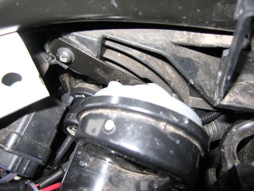

The horn is held in place by one Torx screw on the front of the engine, on the driver's side.

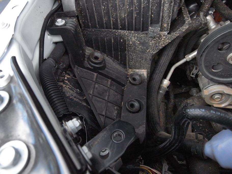

Remove the air box. Loosen the clamp on the air intake hose going into the air box, unclip the clips on the air box cover, remove the cover, remove the filter, and finally remove the air box out. You will need to wiggle it a bit so it comes off of its three rubber grommets.

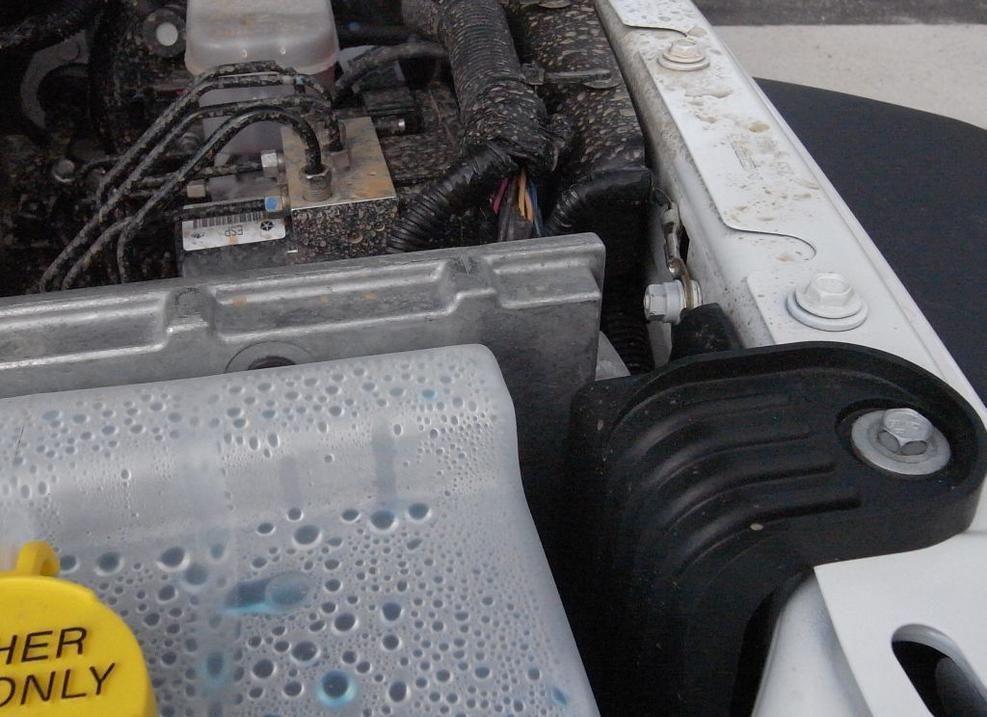

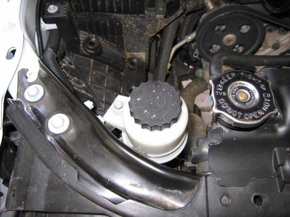

Use your 10mm socket to disconnect the power steering bolt, and then place it on the passenger's side of the engine compartment; don't disconnect the hoses.
  • Figure 3. Remove horn.
  • Figure 4. Air box removed.
  • Figure 5. Remove power steering reservoir, but keep the hoses attached.

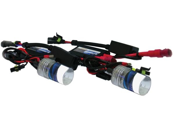

Remove the stock, halogen bulbs by turning them counterclockwise, then pull them straight out. Install the new HID ones by turning them clockwise until they lock in place.
Figure 6. Swap the bulbs.
Step 4 – Install the ballast
Install the ballast underneath the headlights on the front of the Jeep. You can use heavy duty double tape or industrial strength Velcro to keep it in place.
Figure 7. Mount the ballasts on both sides, under both headlight.

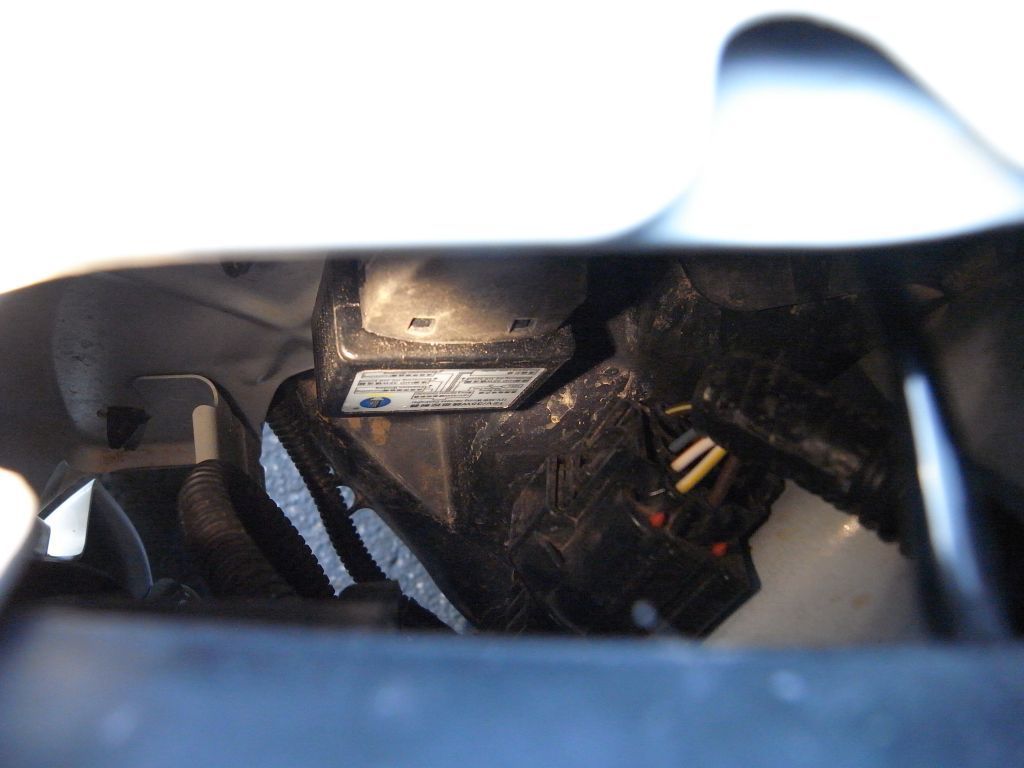

Install the relay control module anywhere you want; a common place is between the passenger's side front fender and the body. Route the wires into the engine compartment.
Route the red wire with the ring connector to the positive battery terminal on the battery. You can run it along the fender next to the factory wiring harness.
The passenger's side ground wire can be connected to an existing body ground. The passenger's side ballast's connector will run to the passenger's side ballast.
The rest of the wiring will go to the driver's side headlight. You can run it along the factory wiring across the radiator.
