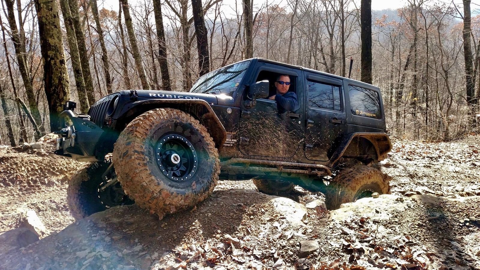

Ready to Rock
Other mods at this time included UD60s with e-lockers and steep 5.38 gears to turn those big tires. With a ram assist and lots of underbody armor, this Jeep is certainly ready to hit the trails.

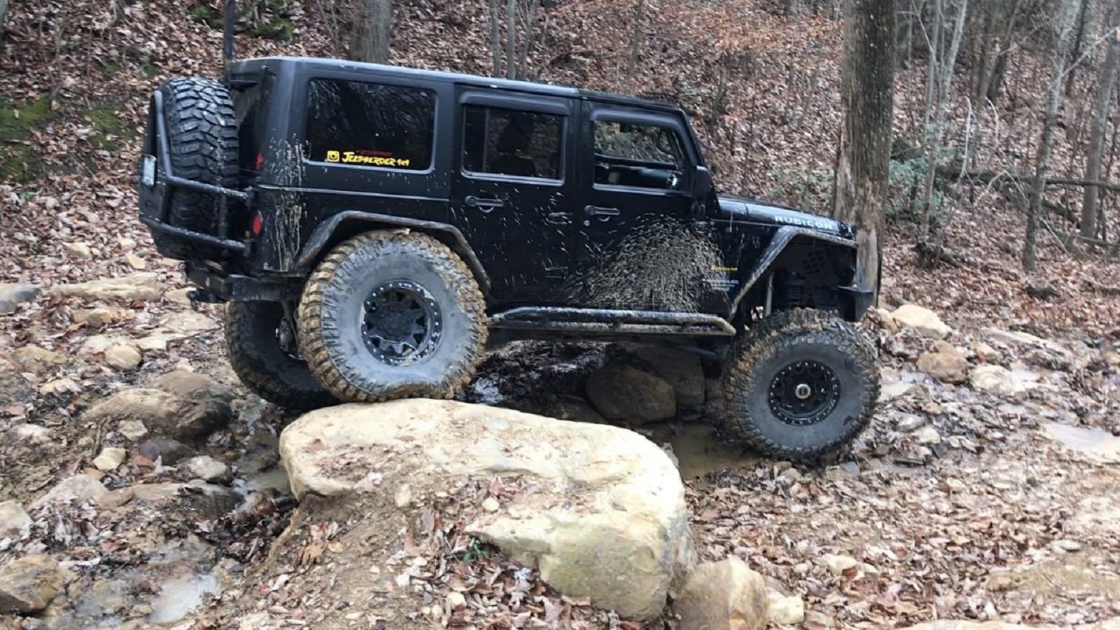

No Mall Crawler
And that's exactly what Dzldust proceeded to do because he certainly wasn't performing all this work and spending all this money on some kind of glorified mall crawler.

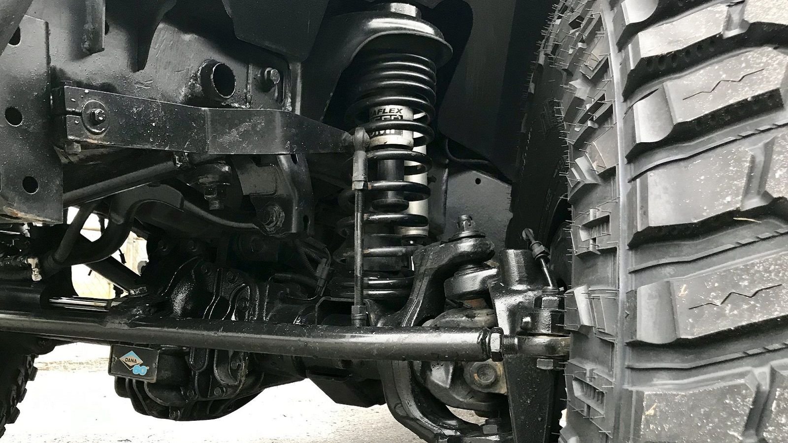

Steer the Ship
After a while, Dzldust further fortified the steering with Teraflex speed bumps and a PSC pump, reservoir, and cooler. After which he called the results "incredible."
>>Join the conversation about Dzldust's Wrangler build right here in JK-Forum.com.
Too Close
From there, it was all about driving the Jeep and making some minor tweaks to ensure it was performing at a top level. Dzldust soon repositioned the ram on the tie rod after learning it was too close to the point where it might bend.

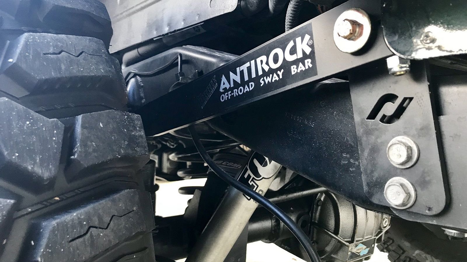

More Modding
More mods kept rolling in as well, including an AntiRock and Teraflex forged rear trac bar. And then, after some more real world "research," Dzldust discovered that he needed to notch the frame to keep the pittman arm bolt from hitting the tie rod end.

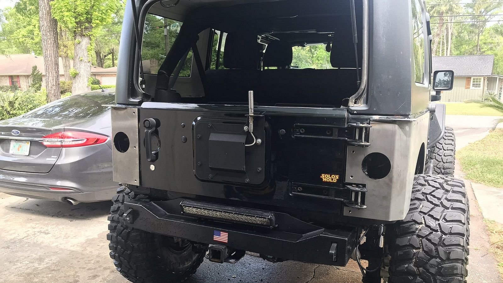

Brace For Impact
The latest additions to this ever-evolving build came in the form of EVO full rear armor, modified Smittybilt Flux XRC fenders, and RockHard C-pillar supports to strengthen up the Jeep for future impacts.

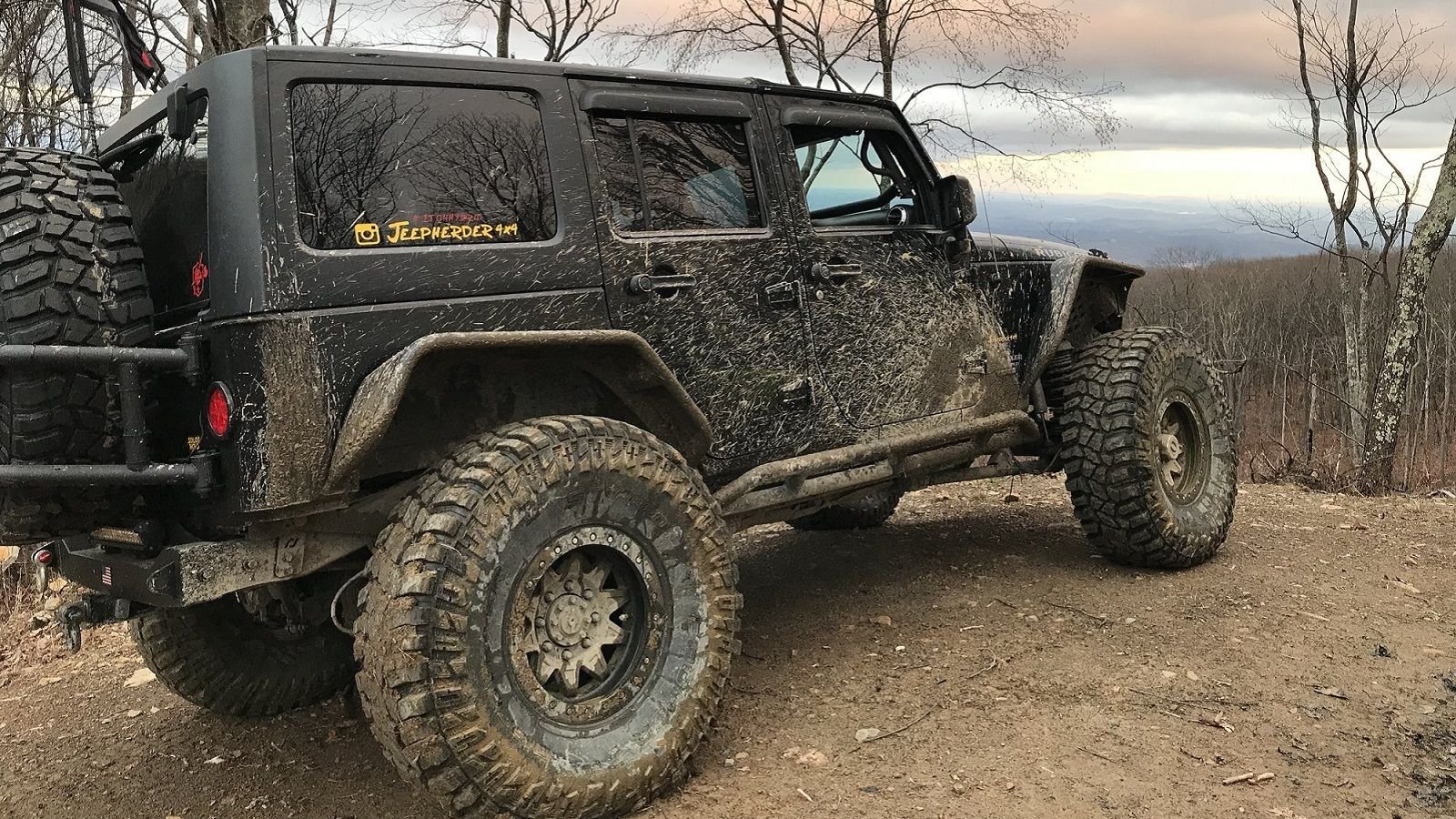

Stay Tuned
This Jeep Wrangler has certainly come a long way in a short period of time, and we don't expect it to stop evolving any time soon. So be sure and head over here to stay tuned for future updates!
