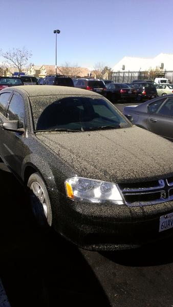

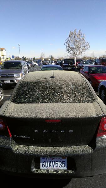

Here's the pic of the rental. I was having withdrawals from not having my jeep or being able to go offroad. So I had to use the rental for my offroading needs lmao
I also returned the rental like this too
