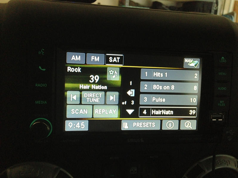

Having problems connecting my iPod to the USB port . It's charging it but not reading it to play music. Anyone else having problems? Please help! Salesman that sold me the jeep said it should work he even showed me a another jeep that it does. The service dept says its not supposed to work. Any help please would be much appreciated

On the 430N radio, the front USB connection does NOT support iPod/iPhone control/playback. To get this functionality with the 430N radio, the separate Uconnect module needs to be installed, where the Uconnect module has a USB connection, which connects to a USB adapter in the center console or the glove box. The front USB connector on the radio is for transferring music/pictures to the internal HDD and will also charge an iPod/iPhone device on the 430N radio.
On the 730N radio, this has a built in Uconnect module and you can plug an iPod/iPhone directly into the front USB connector and it supports iPod/iPhone control/playback.
That explains why the dealership is confused. They obviously don't know much about the differences of the radios and probably showed you it working on a 730N radio which looks similar but is in fact different.
