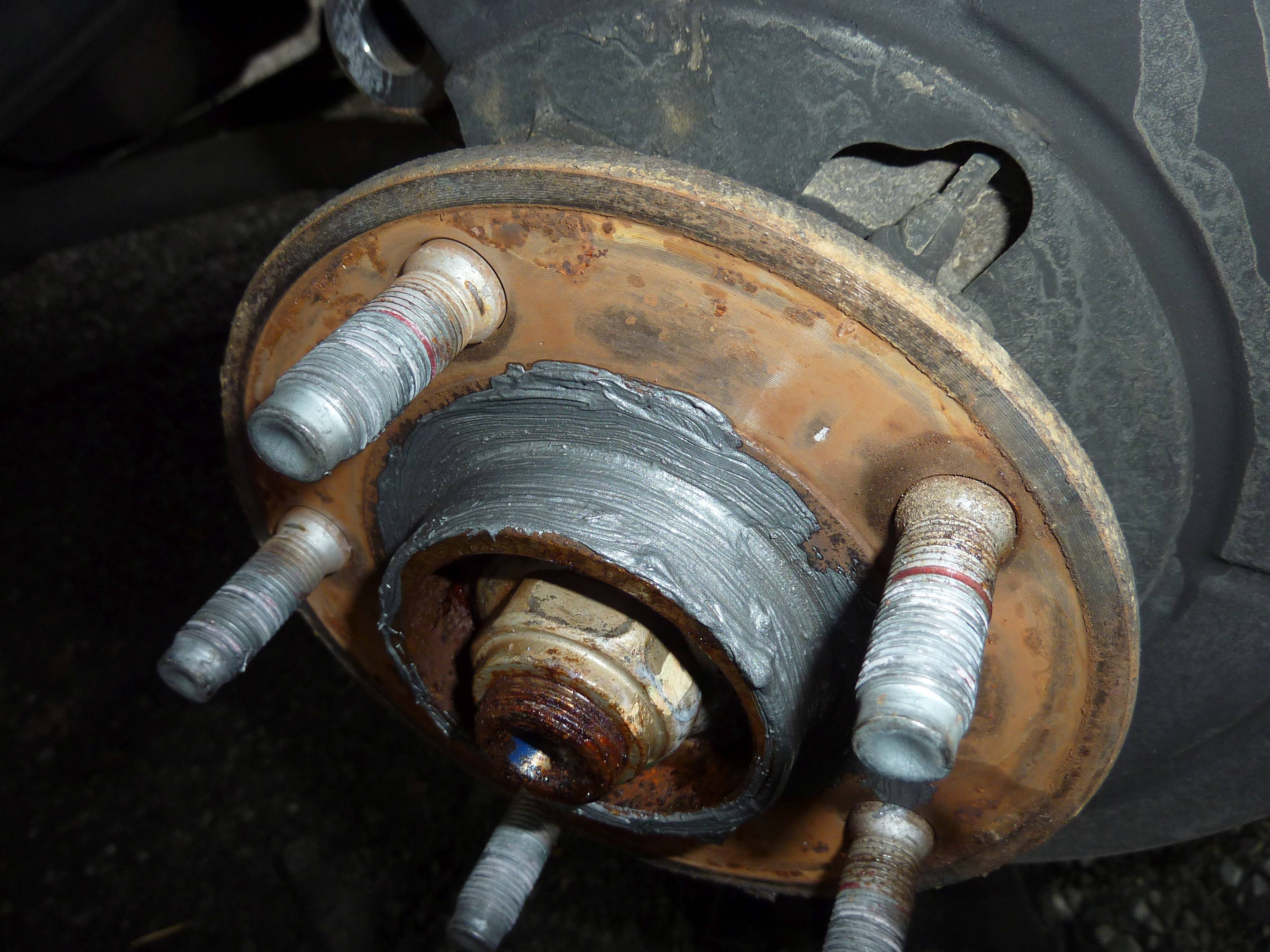

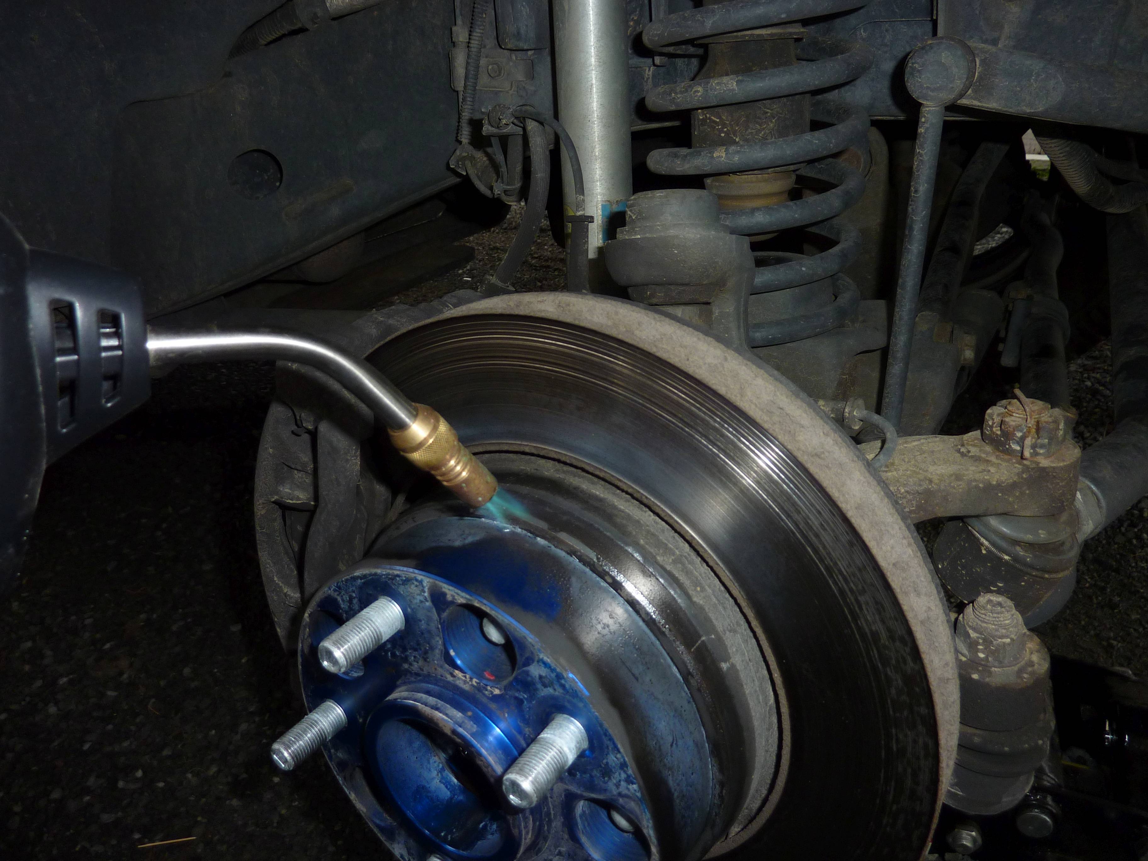

The Spidertrax spacer was bonded to the old rotor. Thanks to the help of forum members' hints I was able to remove it applying heat and gently tapping it. It's important to apply heat evenly and carefully. The spacer came out undamaged.

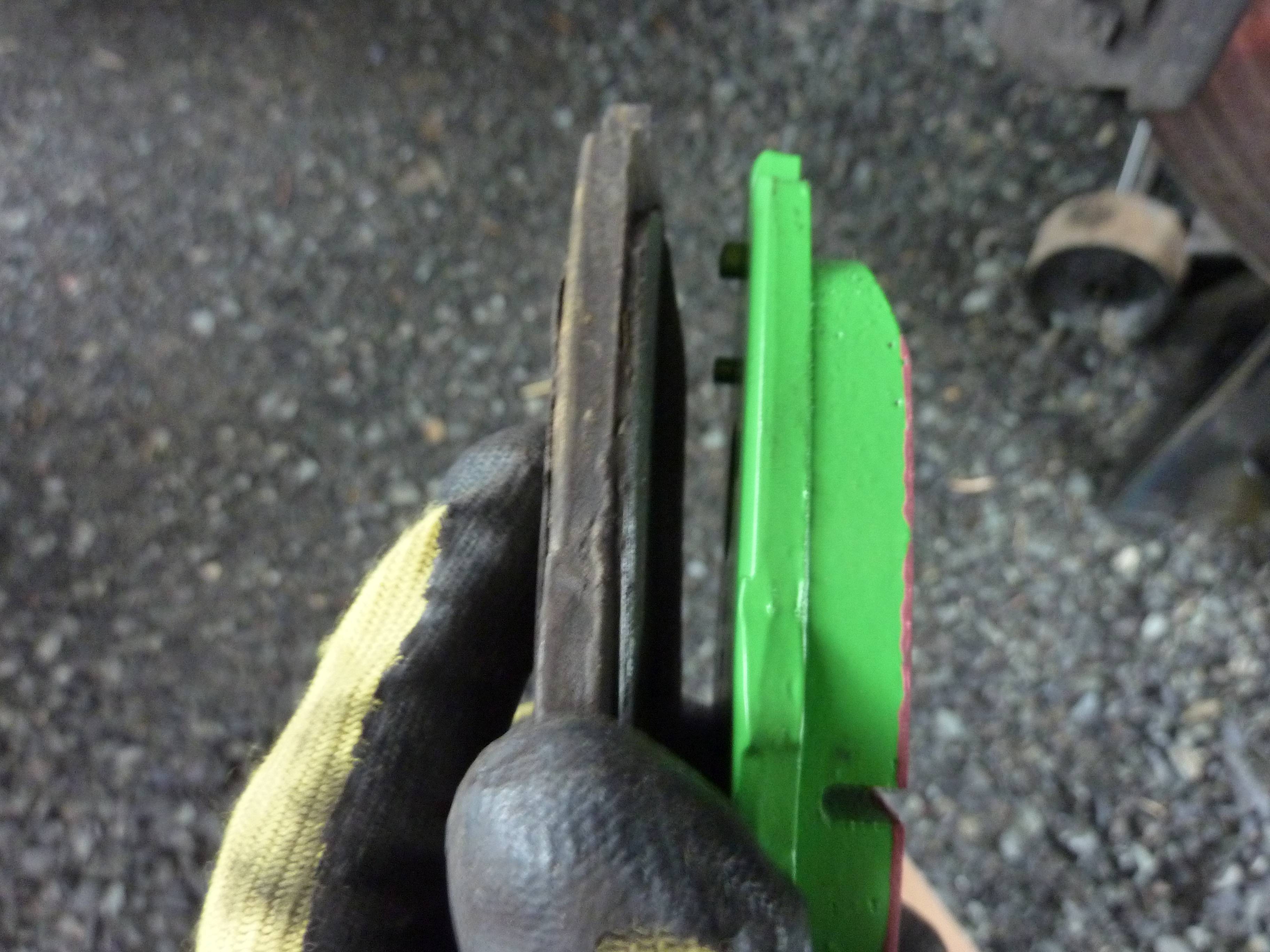

Old pad and new pad. The Yellow Stuff is great. However, it puts out a lot of dust and my wheels became black in no time. After a while I simply let them be.

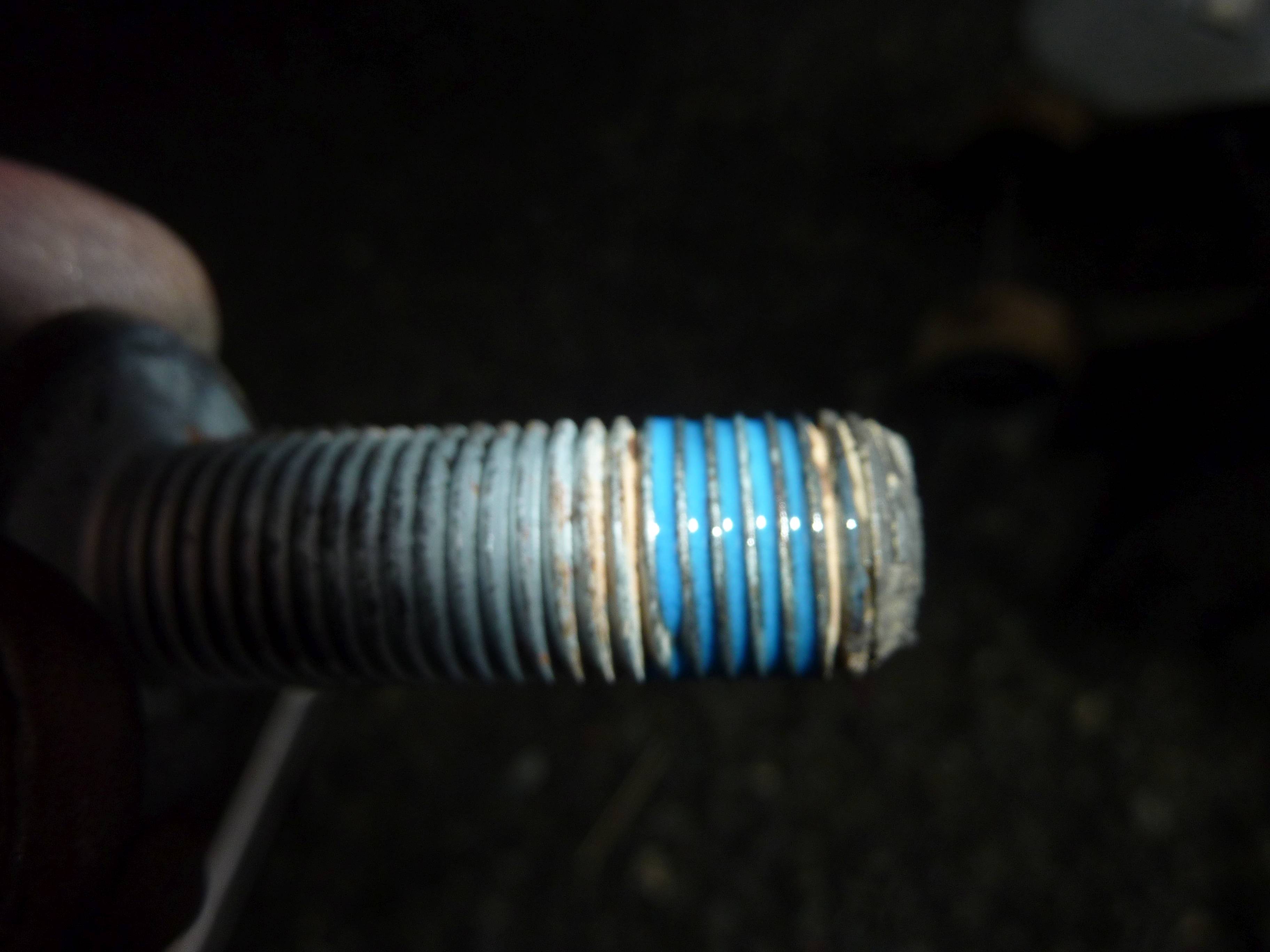

Make sure to apply thread locker.

Remember to apply a generous amout if anti-seize compound. I put very few last time and the spacer binded to the rotor. I also applied between the rotor and its mounting spot.

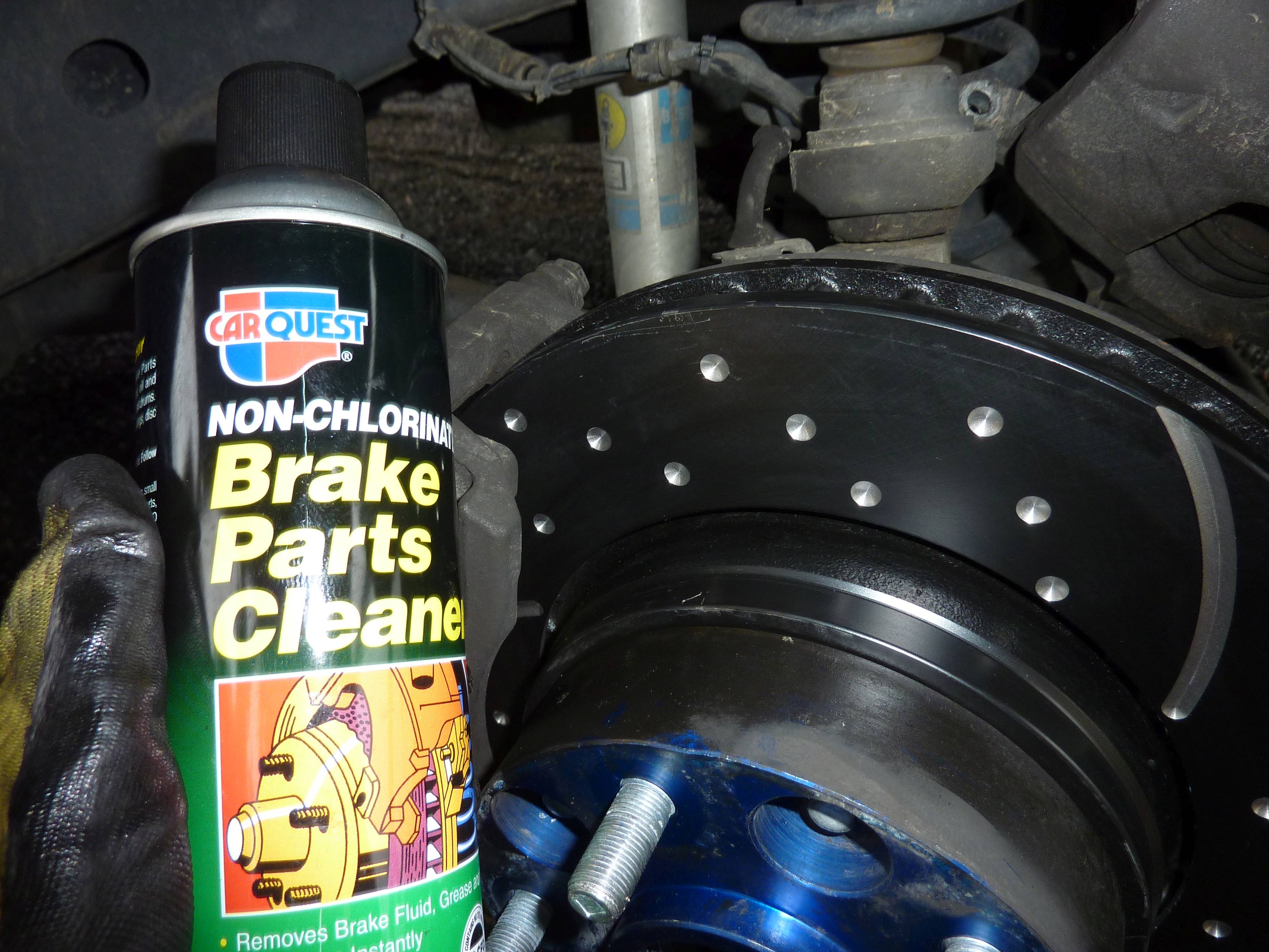

Clean-up the rotor well from grease and any debris. Apply lubricating grease to the brake pads guide slots and make sure it does nto spill into the rotor's surface.

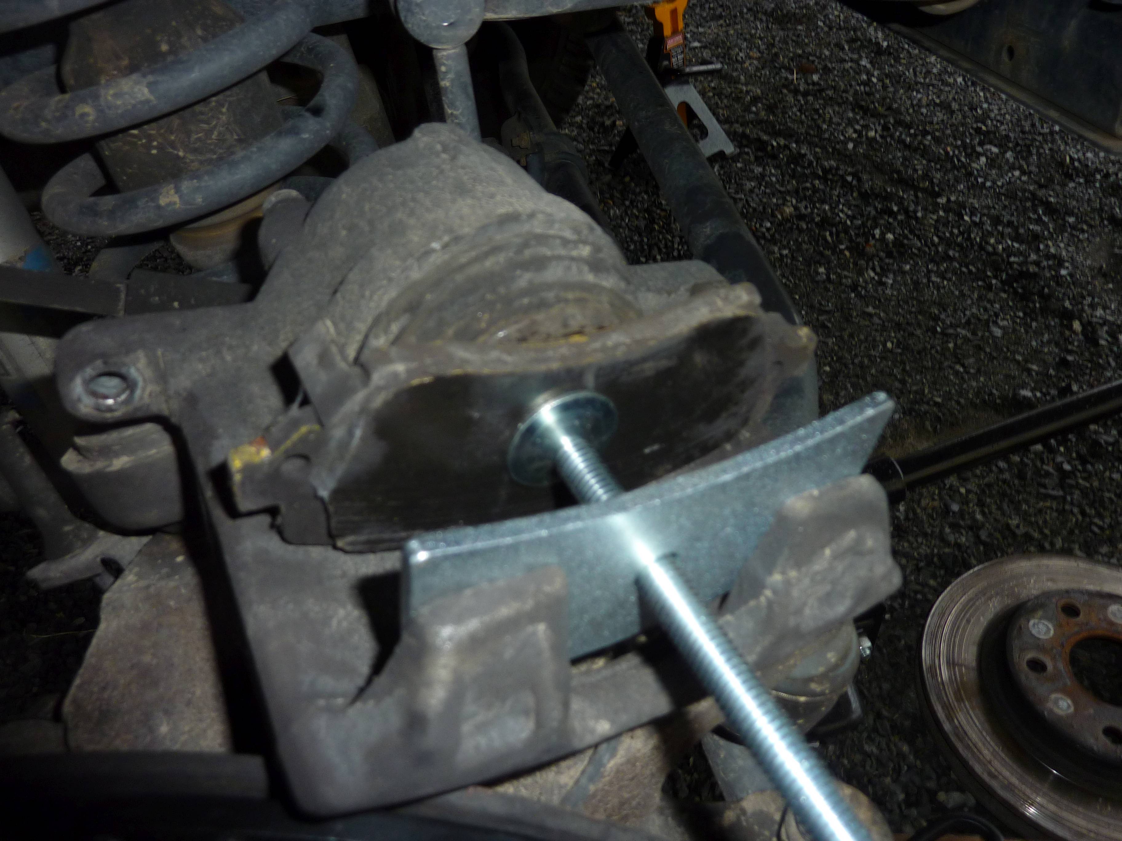

Remember to push the hidraulic piston back in. Sears sells this tool for less than $10 and it works quite well.

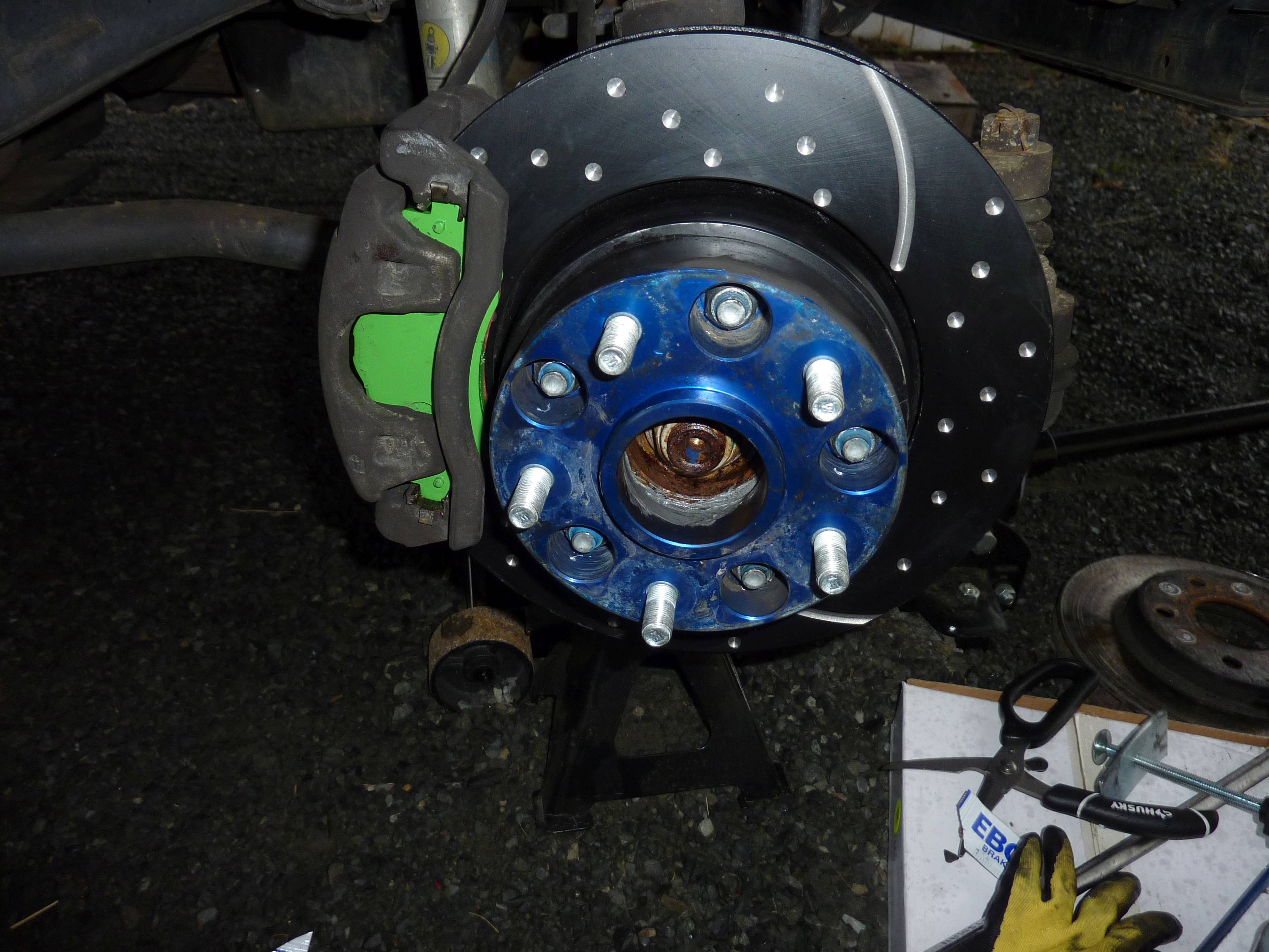

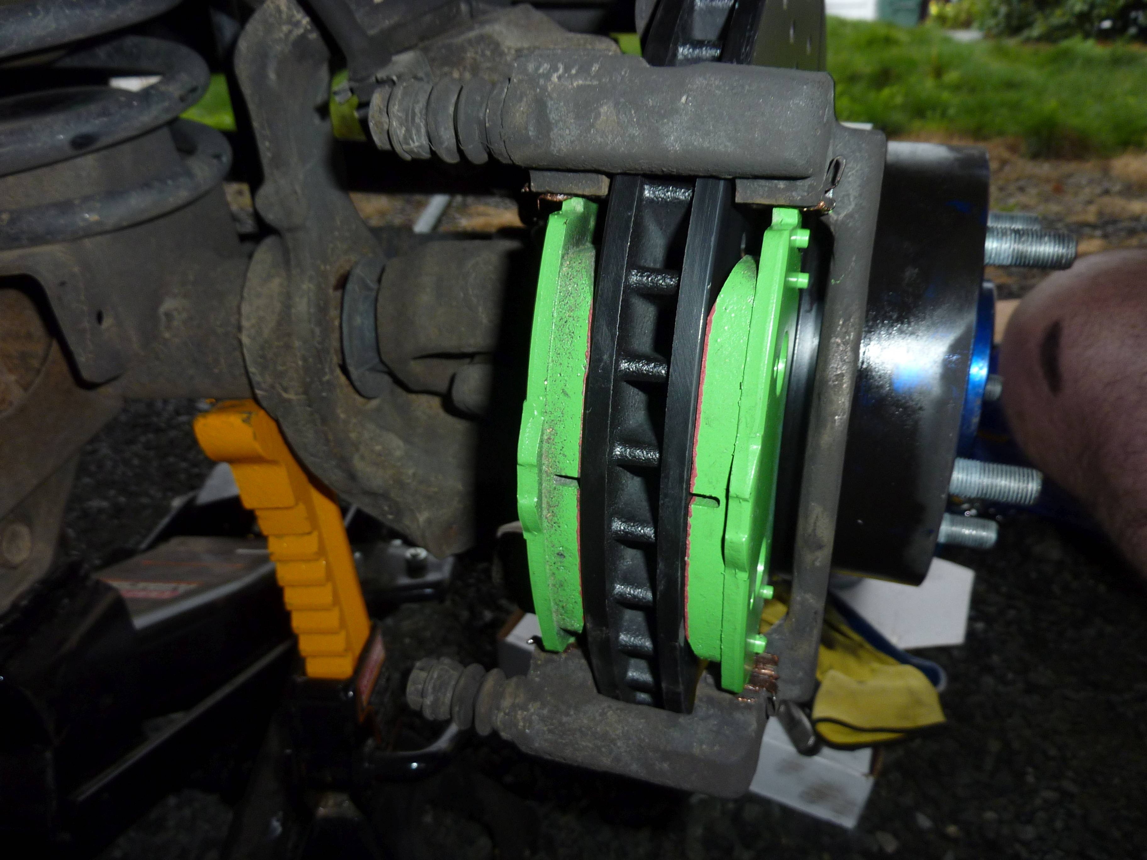

Pads back in place. Now we mount the part with the piston over them. This is why it's important to push the piston all the way back in. The new pads take virtually all space and it would not be possible to mount that part with the piston not completely pushed back in.

Everything back in place. Now mouting the wheels back in and go for a ride to set the new pads and the rotor surface. Before movign the Jeep make sure to pump the brake pedal a few times so the piston comes out and compresses the new pads.

I'm not an expert at this stuff, but Spidertrax highly recommends putting red Loctite on the rotor studs, the ones that hold the spacer on. You just did the opposite by putting anti-seize on the threads. I would recommend that you reconsider this decision. The only failure of wheel spacers that I've seen on the interwebs is from the rotor studs coming loose due to improper torque or not using red Loctite.
The thread locker referenced in step 2 is red Loctite. https://system.netsuite.com/core/med...b9991&_xt=.pdf. I just don't want you to have an issue.
