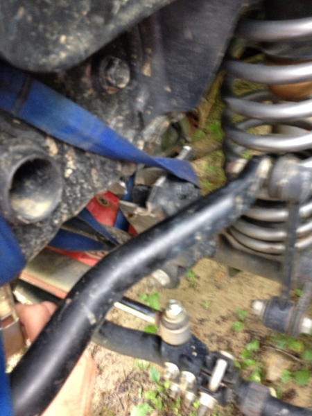

Hi lift extreme saved my ass once already where my winch just was impractical at the angle I was at. Tomorrow it will help me install a new set of bilsteins in the parking lot as I lunched not one but BOTH rear fox 2.0 shocks (torn seals from sand abrading the chrome) out on race point this week.
Get creative... I've used wheel lips, sliders, shackle points, bumpers, cages, tow hitches, tie rods, etc... Just be very careful to respect this type of jack, it can be dangerous, even when used correctly.
