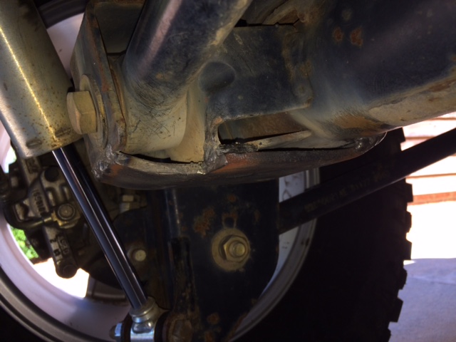

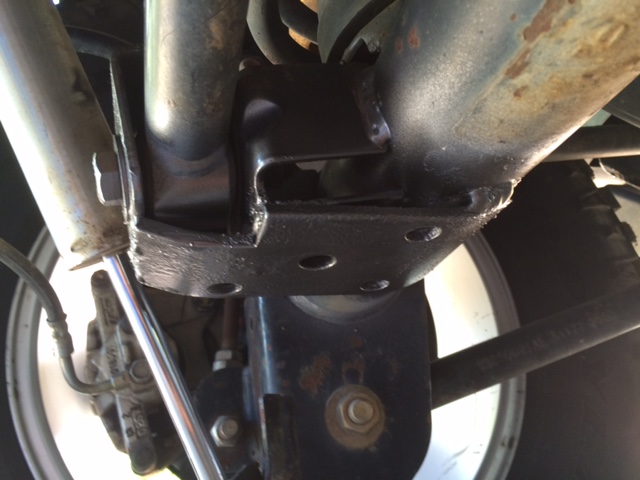

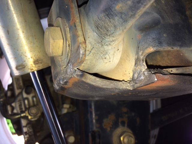

Just wanted to brace up my rear axle track bar bracket. I used a trailer spring ubolt plate and put small notch for track bar movement. Pretty cheap if you already have a welder.
