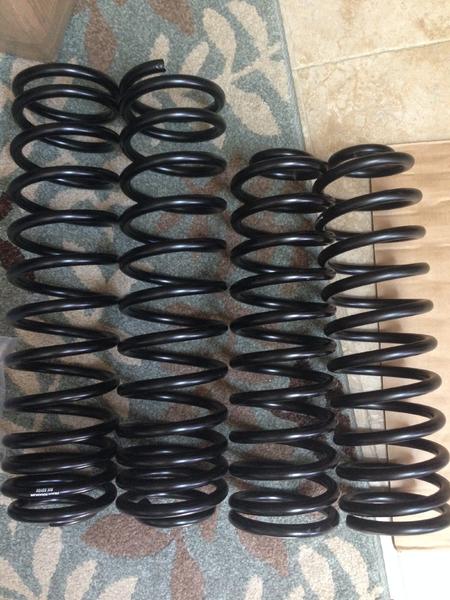

I ordered the new RK triple rate coils, 2.5", from Northridge 4x4. Triple rate is splashed all over the page. I buy them, and after weeks of backorder, I open up the box today and see something suspicious. The model numbers are the same (RK03300/03301), but I take a closer look and the rear coils are the old progressive style that RK used to sell. Thank god I checked, because I feel like I got duped.

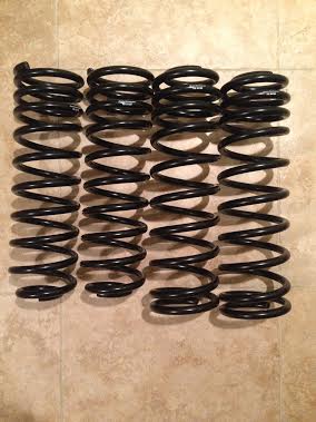

When I sold these, and bought the 1.5" springs, those ones did all appear to be triple rate. So something is fishy...
Cool story, bro-- I know. But, I wanted to remind everyone to check what you order to make sure you get what you wanted. I remember there was an issue with the triple rates before because they all use the same part numbers as their linear predecessors.
The 2.5" springs: (rears do not have closely packed coils)

The 1.5" springs: (notice all the closely packed coils)

I'm pretty sure the Northridge issue isn't their fault due to the fact the springs were sent to me by some bizarre company in New York. The 4Wheelparts issue is just another reminder to do research yourself instead of assuming someone else will get it right. Regardless, had I not caught these and went forward with my install I would have bigger issues down the road. Good luck out there everyone!
not 100% certain but I think they kept the same numbers and I think those look like mine and mine came from RK and they said they were triple rates.

The fronts are triple rate-- I can tell from the closely packed coils at the top. The rears, however, do not have those same feature. They are the same spacing from top to bottom.

That pic you posted was the rear I assume, yes?

My rears are more closely compacted just like the fronts than both of the pictures posted.
