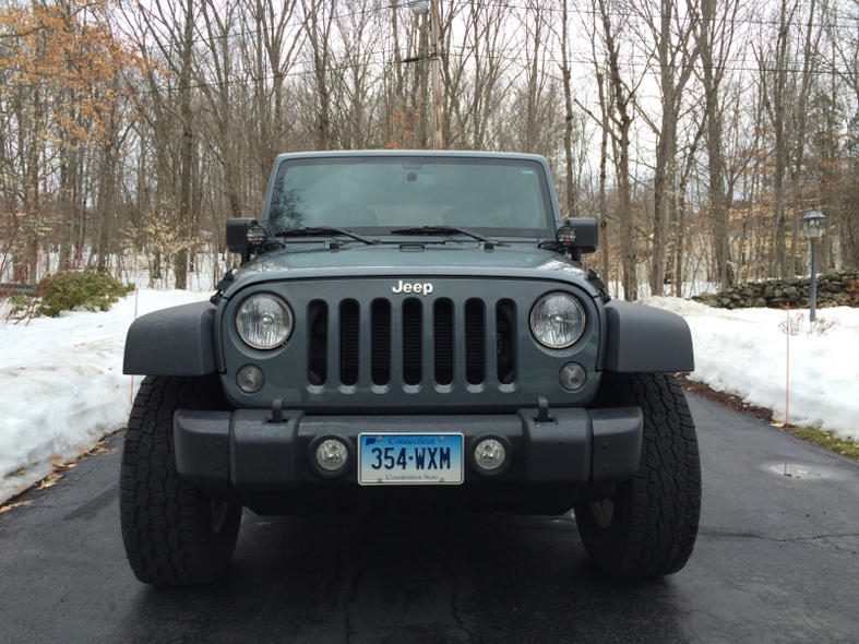

I just put a set of 285/70/17 Toyo Open Country AT II on my '14 JKU Sport and ran them for about a week. A couple times there was a slight rub when the wheel was turned fully to the right. In one week it only happened to me once but it happened to my wife 3 times in one parking lot. I had a new set of 1.5" Spidertrax wheel spacers in case this happened. I was hoping to avoid putting them on but decided to after my wife's driving experience. Now I'm second guessing my decision. I'm a little nervous about using spacers.
I don't think I will be doing any hardcore wheeling with it in the near future before doing other more expensive mods. With the current setup I only plan on some light off-roading if any. My question is, what are your experiences if any with wheel spacers and should I keep them, or take them off and adjust my driving to avoid cutting the wheel all the way right?
