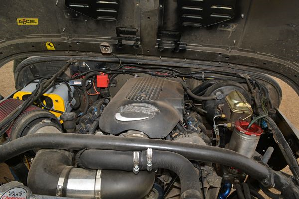

Just ask Sergio Martinez, owner of this trophy-winning YJ rock crawler, highlighted in a recent Four-Wheeler report. The Jeep YJ’s winning list of mods grew out of a desire to build something beefier, after it blew out a 9-inch rear-end for the third time.

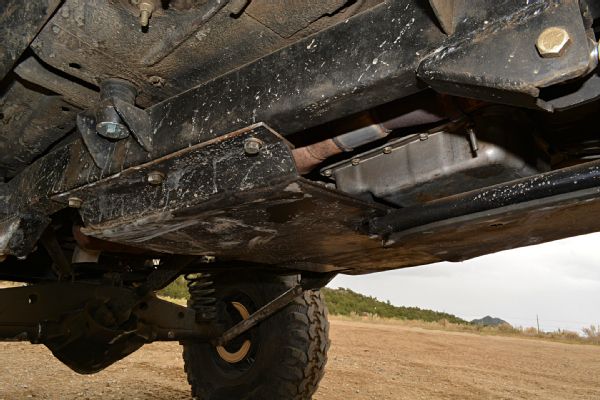

One of the first moves included adding a 14-bolt rear axle from an ’85 Chevy G30 van and a Dana 60 out of ’97 F-350. Martinez also moved the axles to give the Jeep a 108-inch wheel base, in order to perform better on the trail.

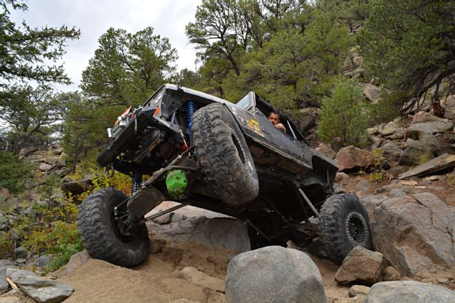

The Jeep also features a custom 4-link front and rear suspension. It was built using aluminum links, 5⁄8-inch Heim joints with 3⁄4-inch shanks, and 35-inch limiting straps. On the front of the YJ, you’ll find 2.0 King 14-inch coilover shocks, and stock TJ front coils with universal coil buckets modified to fit the Jeep.
Martinez’s Jeep also underwent a serious engine and transmission upgrade, including pulling a 6.0-liter V-8 from an ’05 Chevy 2500. The Jeep also features a 10,000-pound capacity winch mounted on a steel front bumper, another one of a dozen hardcore mods made to the SUV.
