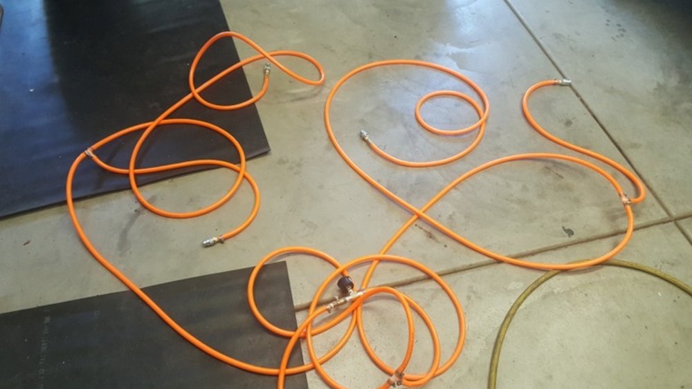

“I’ve used the set-it forget it deflators and for the most part they work but they do fail too and aren’t very accurate tire to tire. The ARB style where you pull the valve core works really well and is fast. But with all those that I have used I ended up building my own 4 tire inflation\deflation setup. I hook up all 4 tires and can have them deflated in 4min (30lbs to 15lbs). I can also inflate my 4 37’s in 2.30 min with my shop compressor or CO2 or my OBA takes about 5min(that’s all 4 tires)”
jchappies deflator
As you might expect, several members quickly asked about that four-at-once deflator system, so jchappies posted the video below, showing his system in action on his Jeep Wrangler.
Here also offered a parts list for those members who want to build their own system similar to his:
“I deflated all 4 tires to 10 lbs, it took 2:30 to inflate ALL 4 37in tires to 30 lbs. My compressor is 5 CFM@90psi to compare to yours. I had some of these parts so it was cheaper for me.
1: 1-50ft of 3/8 air hose- Home depot 13.00
2: 4-lock-on air chuck (closed)- Amazon 10.81ea
3: 3- Barb “T” 3/8×3/8×3/8- Home depot 6.00ea
4: 12-1/4to5/8 hose clamps- Home depot 5.00 a bag of 10
5: 2-3/8 barb to 1/4ntp brass-Amazon or home depot 3.60ea
6: 1-1/4×1/4×1/4 NTP brass “T” Amazon or home depot 7.00ea
7: 1-1/4NTP valve-Amazon or Home depot 3.50-7ea
8: 1-1/4×1/4 brass barrel- Amazon or home depot 3.00ea
9: 1-1/4 NTP air gauge rear mount-Amazon 10-20.00ea
I had a lot of this stuff laying around besides the hose and air chucks to complete it it was pretty cheap but going out to buy everything can be upwards to 100.00.”
