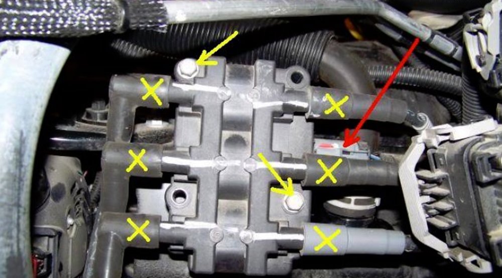

In many vehicles, changing the PCV valve is as easy as opening the hood, locating the valve, pulling it out by hand, maybe disconnecting a hose or two and plugging the new one into place. In the JK Wrangler, the PCV valve is located under the coil pack, so to change the PCV valve, you have to remove the coil pack.
That sounds intricate and it might scare some owners off from trying to tackle this project themselves, but it really is a simple job.
The coil pack of the Wrangler is cleared out by removing the two bolts highlighted with the yellow arrows by the OP. You remove the plug wires, you remove those bolts and the coil pack flips out of the way, making the PCV valve easily accessible.

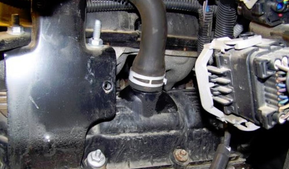

The next headache is that the PCV valve is recessed into the valve cover, so after removing the hose going to the PCV valve, you have to grab the tube on the top with a pair of pliers and pull it up out. The OP found that just grabbing it with pliers can just crush the tube, so he put a zip tie on the valve pipe and then used the pliers to pull on the zip tie. It seems that with vehicles that have the PCV valve changed or checked with some regularity, the zip tie method works, but others took a different approach.
Jeep Wrangler PCV in Tube
For those folks who can’t make the zip tie system work, they put a small bolt into the pipe sticking out of the PCV valve so that it won’t crush. Next, they grab that pipe with a pair of vice grips, then they put a screwdriver through the vice grips, prying against the intake manifold to pull the valve out of its housing.

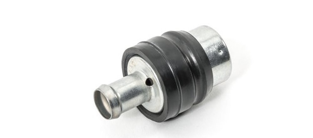

The PCV valve in the Jeep Wrangler engine is hard to pull out of the valve cover, so it should come as little surprise that it is a tight squeeze to get the new one into place. You can’t apply too much pressure to the new valve or you risk damaging the metal pipe sticking from the top. To avoid doing that, the OP and many other members found that putting a socket that is big enough to clear the pipe but small enough to fit into the recessed opening will make it much easier to install. Add a long extension to the socket and you can gently tap the new PCV valve into place.
Jeep Wrangler 3.8L V6 PCV Install
