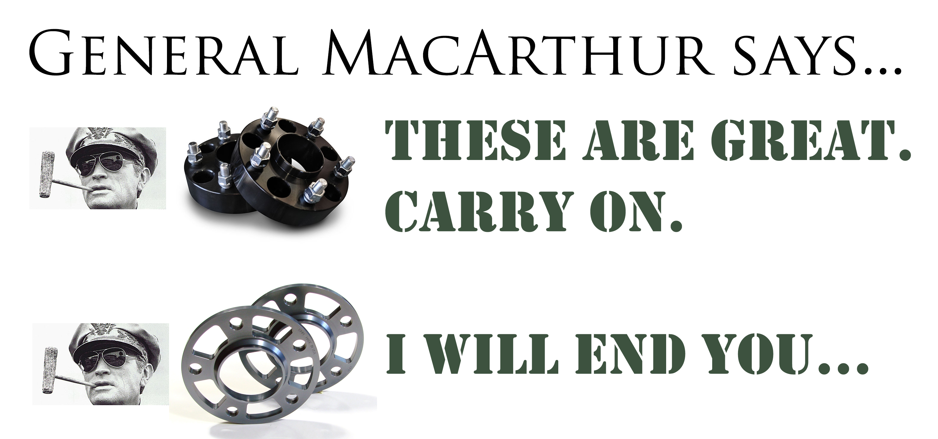

Well if you read through the pages of the thread, you will see that the spacers are perfectly safe, so long as you buy proper spacers and use them correctly. The real key is that “proper spacers” part. You see there are lots of cheap spacers on the market that are little more than a slab of metal that fits between your wheels and your axle hub. These types of spacers are super bad, and will cause much more harm than good. If you use them, it is highly likely the ghost of General MacArthur himself will possess your Jeep and give it a death wobble at any speed over 3 mph.
Nobody wants that. Instead, buy spacers that are solid, and feature double mounts. Basically, these spaces fit over your wheel studs, and they come with low profile lugs that will bolt the space to your axle. There is a second set of studs built into the spacer that your wheels will bolt to. By having the spacer bolt directly to the axle, you are creating a strong and sturdy connection. All you need to do from this point is check periodically to ensure that the lugs are tight. Most users never see any loosening, but it’s better to play it safe than sorry. Check and tighten about 35 miles or so after installation, then check again every 10k miles or so. That is about every tire rotation, which makes it the perfect chance to check them.
