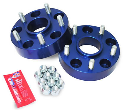

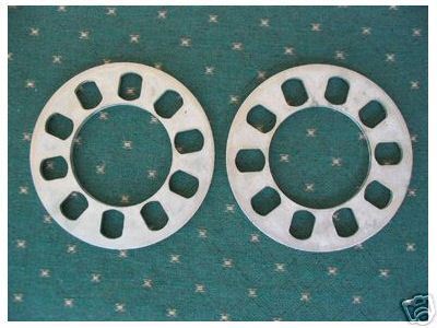

... and, from what I've read here (and it makes sense), as long as you get the kind that bolt to your axle, then utilize new studs to bolt the wheel to the spacer.
GOOD
DO NOT...
I REPEAT...
DO NOT use the kind that simple occupy space between your wheel and the mounting surface. That's the kind of spacer that can be (potentially) dangerous.
BAD

Good Type:
Bad Type:

Originally Posted by TEEJ
Good Type:
Bad Type:
Copycat...
