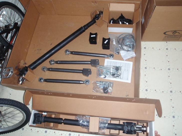

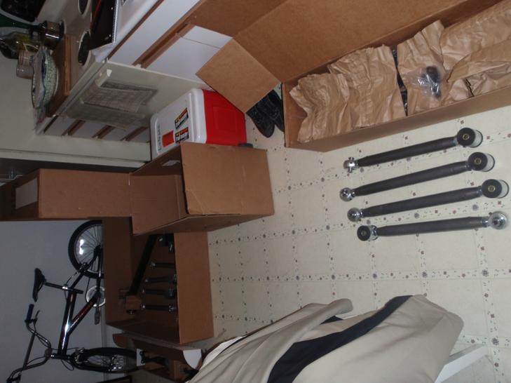

you need a better foot model

hahaha true....
only thing I am worried about is there is only one track bar I think in the kit...
And I do not know if I can use my stock E-disco or if the kit is too large for that...

you can use the stock e-disco, lift doesnt matter. Just buy longer links.
I seen a trackbar bracket. you might wanna buy another adjustable one.

everything is soo freaking beefy I keep going into the kitchen and picking stuff up and looking at it again... hahahaha

nice lift joey , feet not so much, what kind of stereo equipt are you looking to get rid of

I've done plenty of those lifts, pinion angles are set easy on the JK with an angle finder and a jack under the diff. Lock in the control arms once your angle is set.
But, if you want a Jeep pro to install it, the price will DEFINITELY be a lot less than what he said. It's only 8 arms, springs, shocks, brake lines, and bumpstops.

Yea, I figured... at first we though there was welding or drilling involved...
With zero welding and zero drilling it changes from a two day work intensive setup to a one day air tool set upt

Sweet lift joey those arms look beefy!! Whose shocks does trailmaster use i cant make it out from the pics on my blackberry? Do they have their own

I never understood what made this kit worth the ~$3,100...
Now I know...
What an awesome win.
