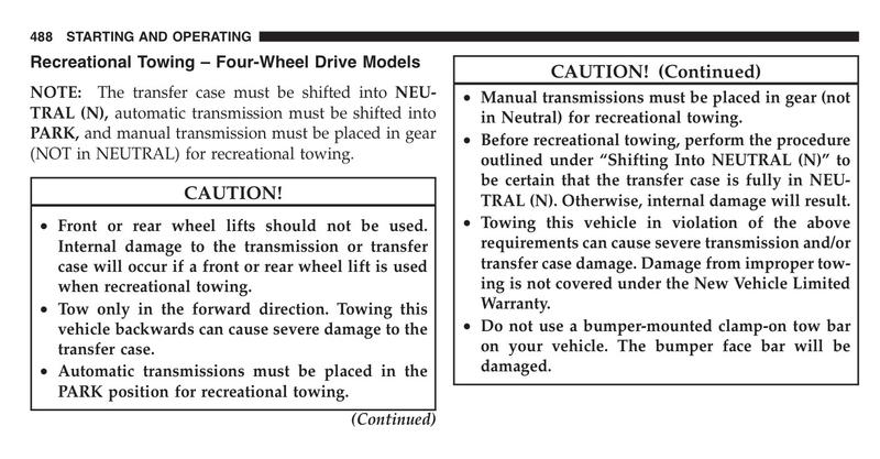

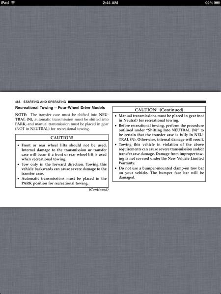

So guys, what's the proper procedure if you need to tow a 4WD Auto?
Old Mar 23, 2013 | 04:48 AM
aldaman's Avatar
Posts: 2,565
From: HAWAII
Well for our Jeep, you should leave the trans in "park" but shift the 4wd lever to neutral to disengage the driveshafts from spinning...
