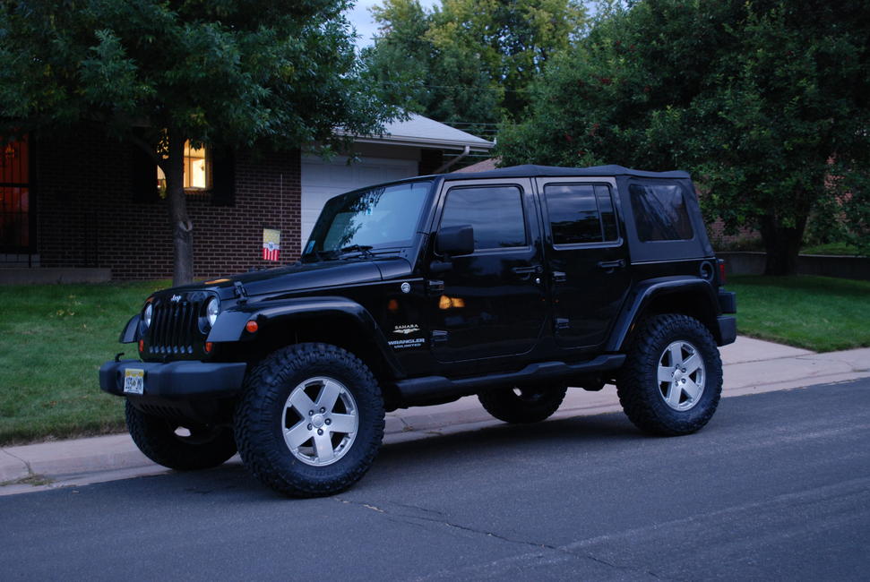

Default Finally Done
Well its finally complete (almost). Tires took a while and they forgot to order the spare.. ol' well, get that tomorrow.. Also, I'm rubbing the plastic guard on the front, so taht will probably come off tomorrow.. I'll do a write up tomorrow hopefully..
Here's a teaser as it got to dark/late tonight.. give me your comments..

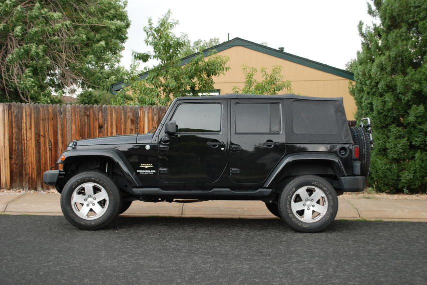

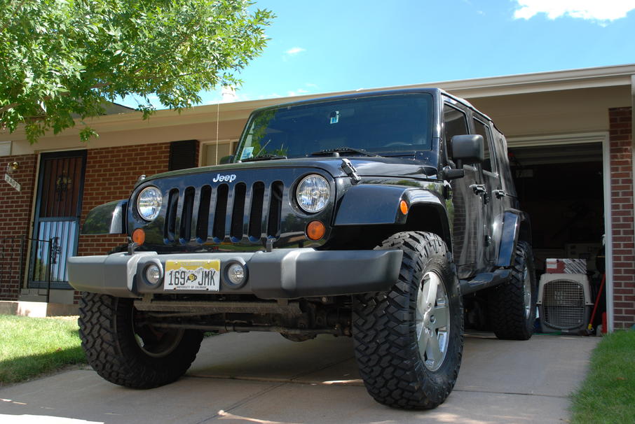

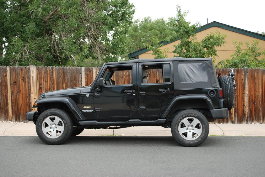

Install.. went more or less by the books. the thread on here https://www.jk-forum.com/forums/show...5”-Spring-Lift is a must. you almost don't need teh instructions. (almost). Instruction say inside for the swaybar links, I installed like stock, which was outside. the shocks interfere if you do them inside. Front Passenger side was the hardest. put the spring in then installed teh bumpstop.. not too difficult. Had a little wobble, but then got teh new tires and alignment and everything rides great. Nitto has done one heck of a job on the tires. I don't really notice a change in noise except when you go between 0-5 mph, you hear the nubs. and over 65 you get some wind, but this is being picky. the ride quality is smoother on the road, but bumps are pretty stiff. oh and the jeep seems quieter for whatever reason. Install took about 7 hrs with the help of fawkes. I did have to pull off the plastic piece under teh bumper as I hit it at full turn. can't decide if I want to trim or just leave off..? Gonna take it up near Vail this weekend and see what I think, nothing too extreme though with the 6 mo old in the back so i will post more pics than this. let me know what you think....
Before
Name:	Jeep Lift__026..jpg
Back
Name:	Jeep Lift__035..jpg
Lift
Name:	Jeep Lift__040..jpg
Tires
Name:	Jeep Lift__047..jpg
Up Close
Name:	Jeep Lift__002_01..jpg
I took a lot of before shots and can compare images if needed. let me know if you have any questions..
