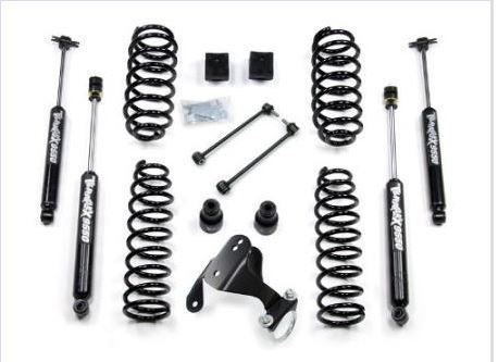

Is this what you're looking at?
You can build around a start up kit for sure, the issue is that it's kinda frustrating....the problem being that everything is connected and works together. It's really hard to change just a few things here and there and not see immediate effects elsewhere. So, it feels like you're constantly having to address things. If you wheel the jeep, these little things become apparently quickly.....maybe not as much if you're just on the pavement.
I try not to get caught in debating specific lifts cuz you can run in circles all day long. What I'd say about that specifically is this:
1) does not include either front or rear adjustable track bars. At 2.5" lift your front axle will be shifted a bit driver's side, rear axle a bit to passenger side. Won't be awful, maybe just 1/4" on each, but it's not ideal. Keep that in mind for a future upgrade.
2) I'd rather be able to pick the shocks of my choosing than be stuck with something that comes in a kit just cuz it's packaged together. You can use any appropriately length shocks. Person preference there.
3) by lifting, even 2.5", you're going to lower your caster. Look at some control arm drop brackets to raise your caster back up. Small changes in caster have noticeable effects in real world driving.
4) if adding larger tires, keep in mind upgrading steerring components in the future. Factory ball joints are crap, and people often don't budget to replace those. Upgraded BJs run $200 - $600, and if you can't do the labor yourself, another $250+ for that. If you wheel, a new tie rod could be in your future.
5) Larger tires will have a direct and immediate effect on your gearing.
6) front drive shafts are hit and miss at 2.5". I've seen the TC side boot on the factory shaft give up on a 2.5" budget boost that never left the pavement.....it happens.
7) brake lines are a nice upgrade for the future so that you can ditch the brackets.
Those are just a few things to think about if wanting to build around that.

Thanks for all the info that is the kit will make sure I add at least the front track bar to the initial purchase it's still a daily driver but will soon be a toy

Pick a nice track bar....it's one of the most important components up front. It's not JUST about adjustability. Some models like Teraflex and Synergy have nice methods of adjustability, but they charge you for it too. Just pay particular attention to the frame side joint. You'll see a big difference between what Pro Comp/Rubicon Express use vs. the more reputable manufacturers.
