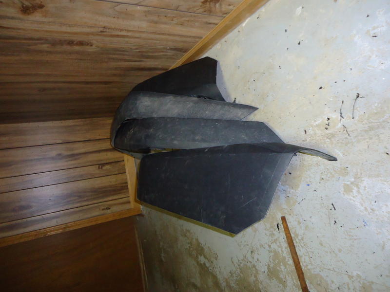

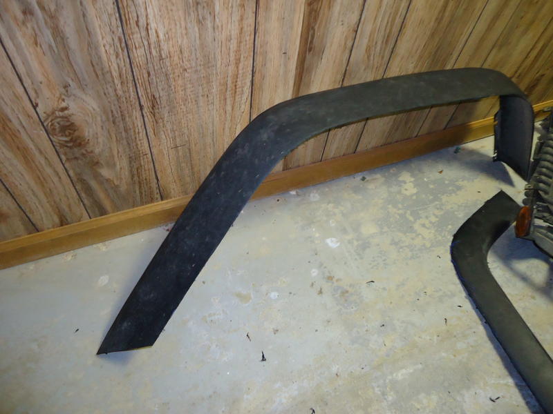

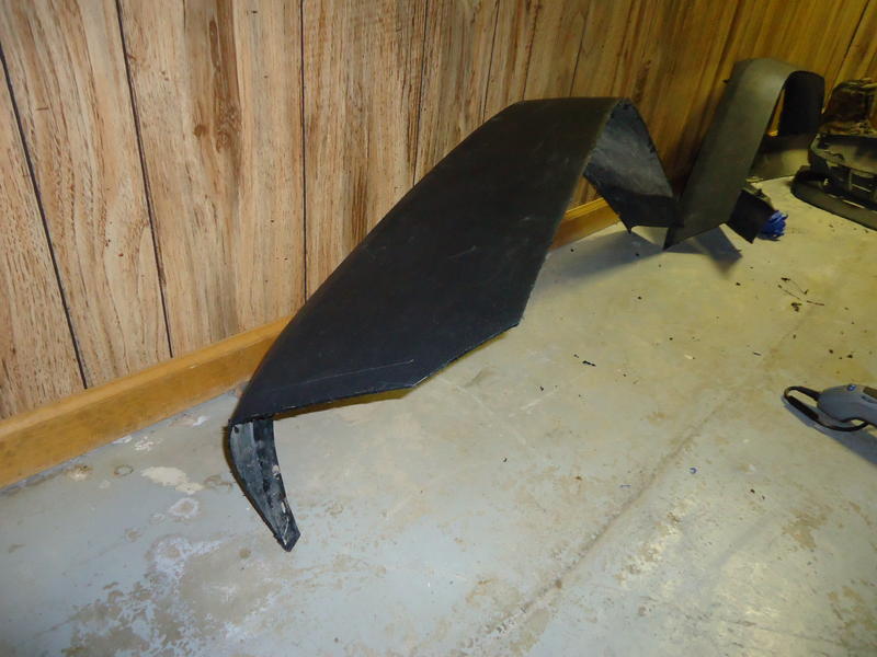

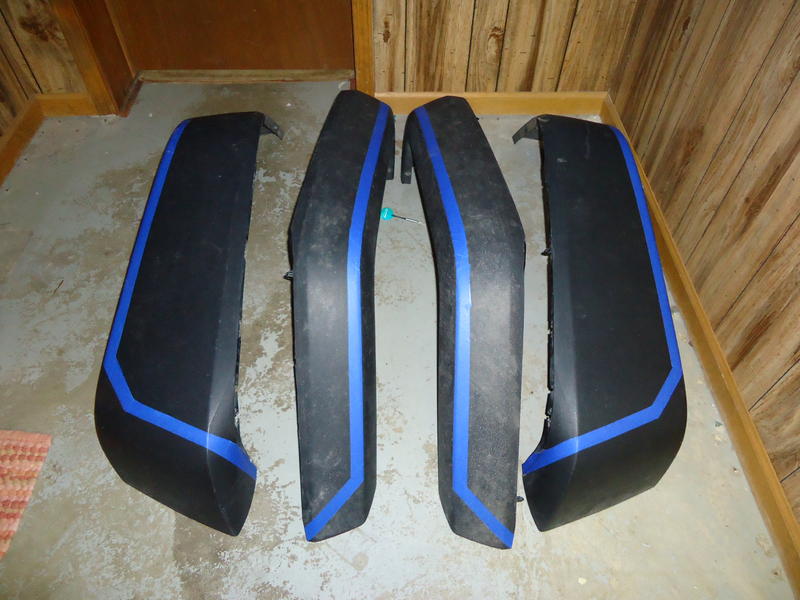

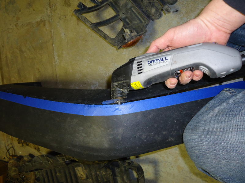

So after about 30-45 min prep time measuring and such I finally started cutting. My tool of choice was the Dremel Multi-Max with a wood/drywal blade and it worked awesome. Now if it would warm up enough to spray all of the damn snow off the jeep, I will get these babies put on tomorrow.
