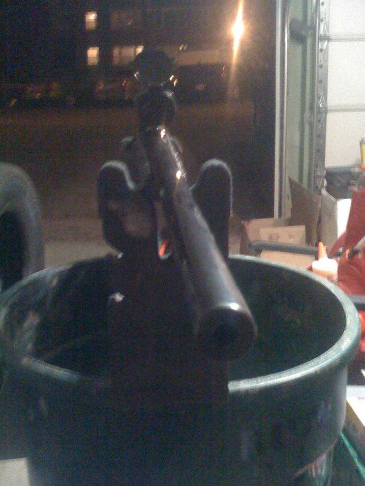

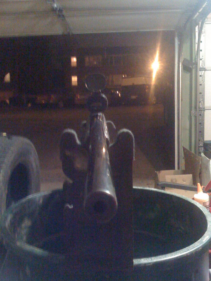

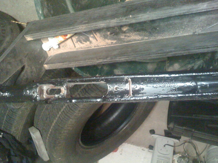

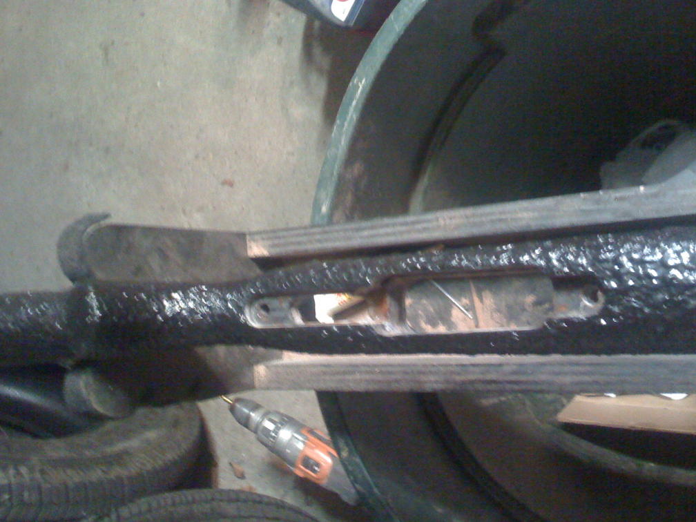

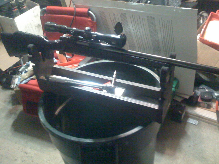

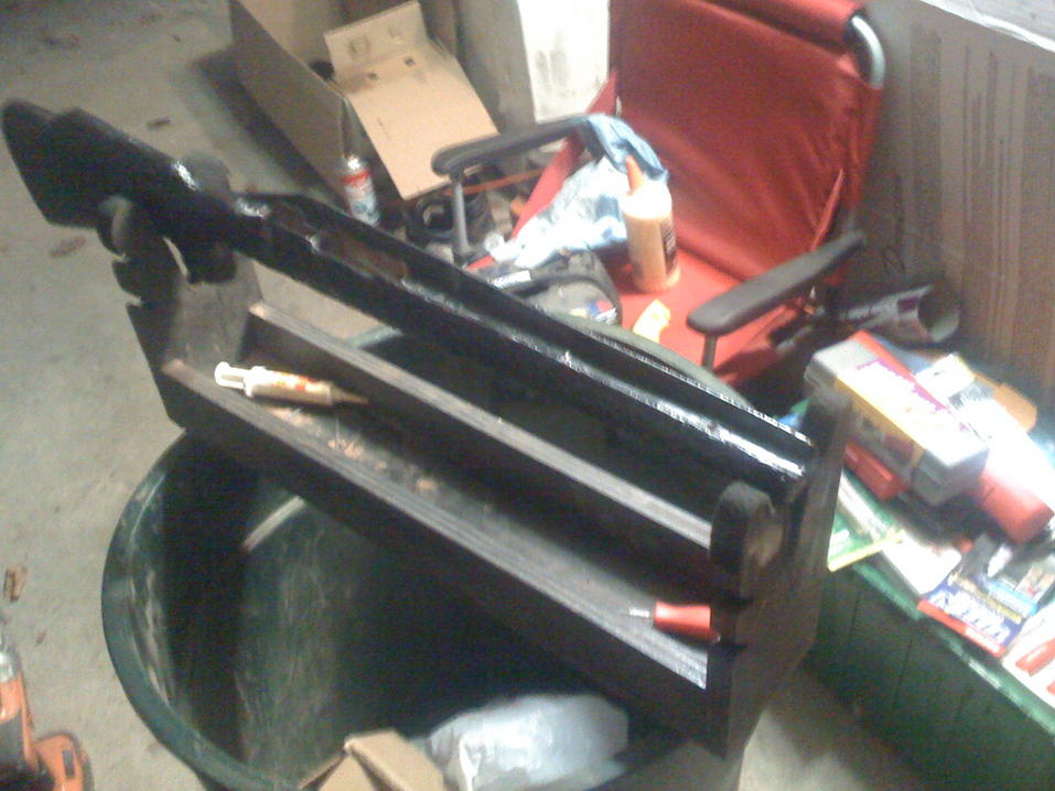

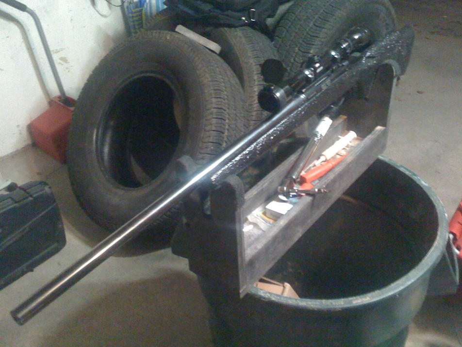

Well, the bedding is done. I just have to sand off the excess, sand the stock completely and paint it.
I decided to sand off the varnish on the stock before bedding, tried bedding it, and messed it up. So i had to grind/sand that crap out, and by doing that, i had to remove some more wood from the stock. So last night around ten my neighbor and i "pre" bedded the stock to compensate for the wood i sanded off (about 1/8"), and when it dried up a bit, he added some more JB Weld and finished bedding it.
My gun is at his house now, and he works till 10pm, so i cant take any pics now. When he gets home we'll resume the "My tack driver" project, sand and paint it with Herculiner. After which we might do digital camo finish.

Default Here are the pics
