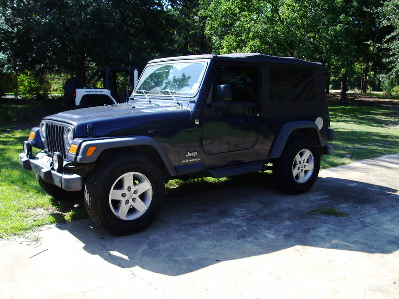

If you get spidertrax adapters that change your bolt pattern from 5x4.5 to 5x5, you can run em.

Yes! with wheel adapters
Lo2aY is correct. Wheel adapters will make 'em work. And he gives a nice example of how sharp Moabs can look!
