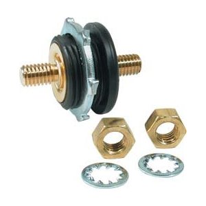

The least obvious way is down and out the back at the pivot point, if it has one. The problem is length of wire, the longer the run the bigger the wire you going to want to use.
I dont know how much power you need at the back of the Jeep, but I suggest running some big wire to some place at the back of the jeep. Then you can use that point to connect smaller wire to all the accessories, like lights.
I used 6G (4G would be better) jumper cables, stripped the ends off. Ran the cable down the frame to the back (make sure you use a fuse on it 60-80amp should work). Then used 2 of these (they come in red and black) mounted on a plate...
From these you can run all the lights and accessories you want without running a single wire from the battery for each.
