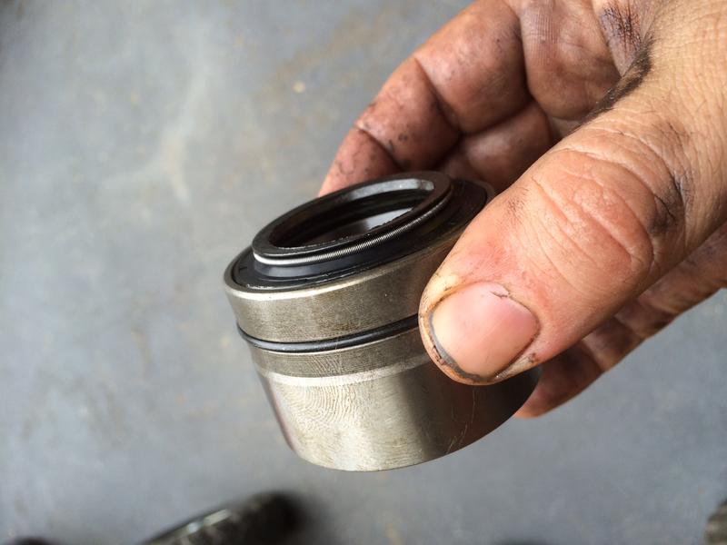

I got a new bearing and it looks just like the old one. I'm pretty sure that the advance guy gave me the wrong bearing and that really sucks but oh well. Hopefully I get it done right this time. Attaching pic of possibly wrong bearing.
