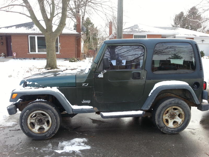

Hey guys lookin for a cheap way to get tires used oem cost way cheaper i was wondering what oem tires would fit a 97 Tj I serearched that grand cherokee does a nice job
does anyone else have any good ideas ?
(got my project jeep for $1500 looking to build it up slowly )
