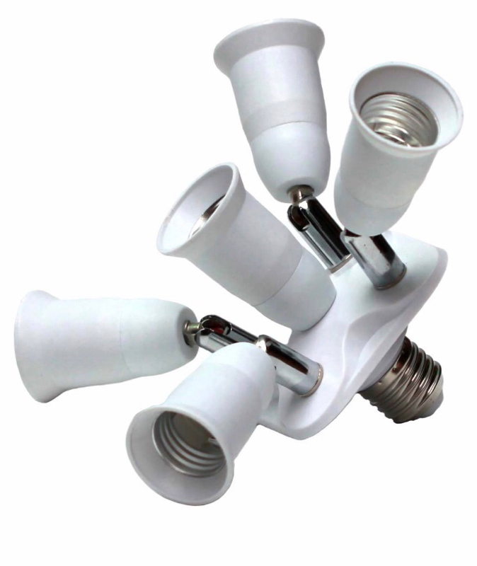

Old Nov 26, 2016 | 11:52 AM
B_Alvie's Avatar
Joined: Oct 2013
Posts: 89
From: San Antonio, Texas
Went with this solution. Added 4 LED floods and 1 single 120 equivalent light in the center. Completely solved the problem for $10 light socket and $20 in lights.

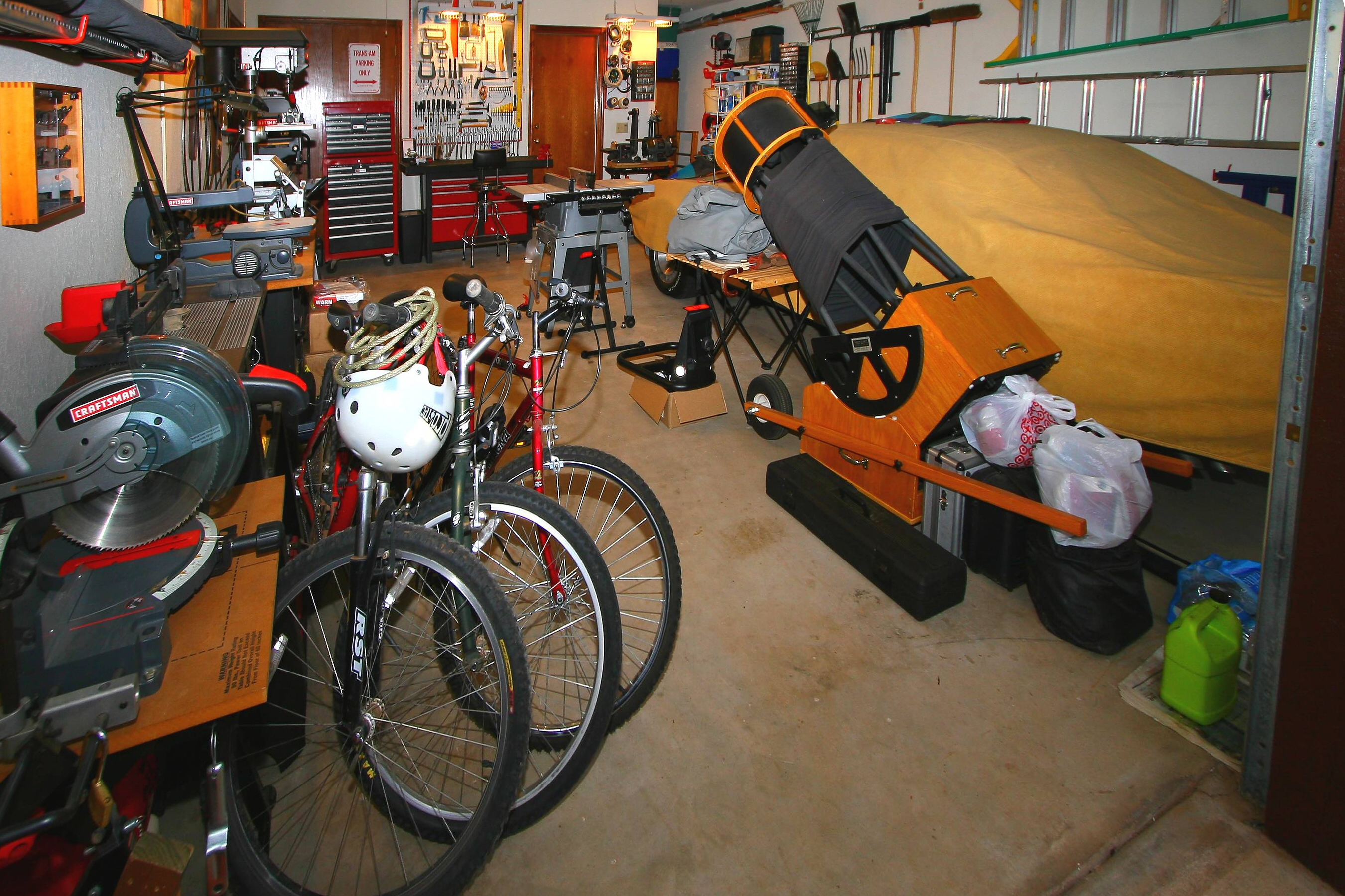

Old Dec 3, 2016 | 01:31 AM
Mark Doiron's Avatar
Posts: 14,800
Likes: 374
From: Midwest City, OK
My lighting is old by today's standards. A couple two tube florescents for general lighting, and then several halogen light assemblies over specific work spaces. I'd definitely go with something more energy efficient if replacing it. If you use your garage for any kind of shop work, then task lighting is important. Even in the daytime (unless you have some nicely placed windows).
Name:	Garage, Feb 08, 9267.jpg
Oh, the answer to that question that you have: It's a 1979 Tenth Anniversary Trans Am and the other is a telescope. :-)
