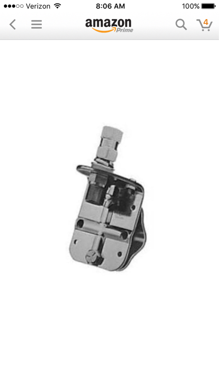

Looking to mount a CB to the rear of my gobi using a universal mounT plus I'll only have the antenna install when on the trail
