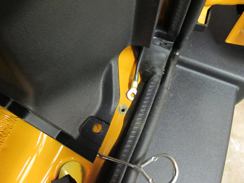

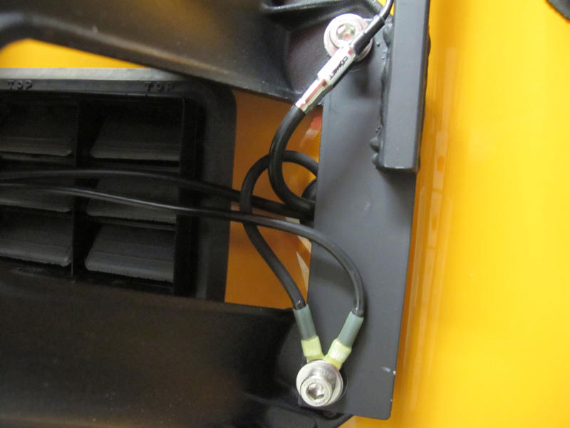

i ran a separate ground wire from the mount bolt through the tailgate to the rear tiedown bolt on mine. The picture didn't have the paint removed well enough and i got high swr like you. then i used a dremel tool to really clean off the paint and got low swr. mine is a different mount, but you could try a ground wire.
Attachment 271712Attachment 271713
You appear to have two wires coming from your mount. Is one from another antenna?
Also, did you need to Dremel the antenna mount side as well as the location for the bolt on the Jeep?

yes, i have a cb and ham antenna, ran a ground wire from the cb mount bolt to the ham mount bolt and from the ham mount bolt to the body ground bolt inside the jeep. you do need to grind the underneath side where the antenna mounts, not the top side. i didn't grind the inside of the mount where the bolts go through, just the outside where the bolt heads are.
