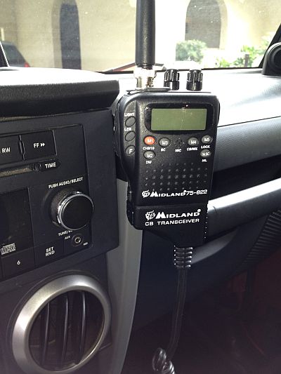

I have my Midland mounted with this which works with a belt clip:
Die-Tech Off-road Dash Utility Mount
I've also seen posts where people have removed the belt clip and attached a mic button so they can use a standard mic holder.
This pic is with the mount before I added the external antenna:

Did it work at all on the trail without the external antenna? I like that even more after seeing your pic, its smaller looking than I expected.

In a small group that stays relatively close together on the trails, it works ok without an external antenna. I used it that way for about 6 months. However, when we got a little spread out, it wouldn't work well. I'd say the limits are about 1/4 mile or so. When a group of us went on a long-distance trip to Alabama to go off-roading and tried to stay in touch via cb on the highway, I realized the limitations. Once I added the external antenna, I don't have to turn it up as loud and the range extended to a couple of miles, even with a relatively short 3' antenna.
I don't have any problems accidentally hitting buttons on the handheld. I like the mount because it's just about the perfect distance for me to grab ahold of, yet it's out of the way and doesn't bounce around.

Thanks that's good info! I've seen a few guys here say that in small groups the rubber ducky works... Specially since as long as weather is decent I'll be topless. I may just go with this then and see how well it works without an external, then if I desire better range I can just add to it easily
