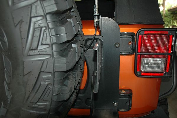

I have the same teraflex hi-lift accessory with the antenna mount. Be sure to remove the powder coat on the underside of the mount where the antenna stud makes contact with it on the bottom side. The nylon washer should go above the mount to isolate the antenna. I was prepared to run an additional grounding strap, but after tuning my 3' Firestik Firefly, I had good SWR readings (1.3 or lower) and my range is excellent so I haven't added any additional grounding.
I ran the coax (18' for my JKU) from the antenna mount to the rubber grommet on the tailgate behind the spare, through the tailgate and then along the floorboard and terminated it at the panel below the glovebox with a PL-259 connector. I can then screw the cb into this connector when I need to use it.
In hindsight, I might have mouted the connector a little higher on the panel so it's pointing more straight out instead of downward, but it works. As mentioned in one of the previous posts, I will also run the audio cable that's shown in the pic to the cb so I can get sound through the jeep's speakers.

I have the same teraflex hi-lift accessory with the antenna mount. Be sure to remove the powder coat on the underside of the mount where the antenna stud makes contact with it on the bottom side. The nylon washer should go above the mount to isolate the antenna. I was prepared to run an additional grounding strap, but after tuning my 3' Firestik Firefly, I had good SWR readings (1.3 or lower) and my range is excellent so I haven't added any additional grounding. I ran the coax (18' for my JKU) from the antenna mount to the rubber grommet on the tailgate behind the spare, through the tailgate and then along the floorboard and terminated it at the panel below the glovebox with a PL-259 connector. I can then screw the cb into this connector when I need to use it. In hindsight, I might have mouted the connector a little higher on the panel so it's pointing more straight out instead of downward, but it works. As mentioned in one of the previous posts, I will also run the audio cable that's shown in the pic to the cb so I can get sound through the jeep's speakers. <img src="https://www.jk-forum.com/forums/attachment.php?attachmentid=548447"/> <img src="https://www.jk-forum.com/forums/attachment.php?attachmentid=548448"/> <img src="https://www.jk-forum.com/forums/attachment.php?attachmentid=548449"/>
Two questions:
1. Was the PL-259 connector already on the coax cable to screw the cb into or did you have to connect it to the end somehow?
2. What audio cable are you using? I would like to order one, just want to order the right thing.

Originally Posted by AnvilX14
Two questions:
This is the audio cable I use: Amazon.com: StarTech.com MU3MMSRA 3 feet Slim 3.5mm to Right Angle Stereo Audio Cable - M/M: Electronics
You can order different lengths. I use a 3 ft. which is a good length for me because I run it to a phone mount close to the steering wheel when I'm not using it with the cb. I like the right angle connector but you can order it with a straight or right-angle on either end.
This is the antenna stud I use: Amazon.com: STUD W/SO-239 CONN: Electronics
Make sure you mount it exactly per the diagram and remove the powder coat as shown here:
Name:	ant-mount grind away location.JPG
I had a little trouble finding the PL-259 connector. I found it on e-bay, but it took the slow boat over from China. I think it took something like 3 weeks to arrive: UHF Female SO239 to UHF Male PL259 with 4 Holes Flange RF Coax Adapter Connector | eBay
It has an SO-239 female side and a PL-259 male side. I drilled a hole in the panel and then attached it to the panel with 4 screws and the coax connects to the SO-239 side in the back. When I want to use the CB, I just connect it to the PL-259 side of the connector.
